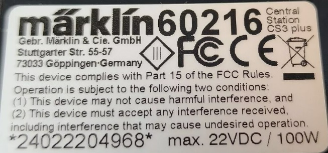

@ marklinist5999: you write that the production year is in the serial number. Do you know how to decode that? For example, I found one CS3 for sale on eBay with the serialnumber 240222204968. Could it be that the serialnumber is on the format "yymmddxxxxxx", indicating production date 22nd of February 2024?

It's 2 of the last 4 numbers. Mine is 06 21 5, or June 2021.

Anyone who can decode when this CS3+ is made?

2020, April, I think. I was going by when I bought mine in fall of 2021 according to the box. The numbers on the device are different. Does te system status give the date? I will check later.
Yours is much newer than mine, it being number 1768?? Mine has no #2's at the beginning. 1's, and 7's.

1) The picture of the sticker on the backside of the CS3 plus is not from a controller I own. As mentioned it is from an eBay-ad.
2) As I wrote, the serialnumber is 24022204968.
3) If I were assigned to make the nomenclature for a serialnumber for a device, it would seem like a good idea to use the format yymmddxxxxx, where yy is the year, mm is the month and dd is the day of the month. XXXXX could be the number of units made, where for example 04968 is the 4968th unit made.
I am very interested in hearing from you all whether you think it is important to get a unit that is produced as recently as possible.
I would also very much like to hear from you all what the first 6 digits of the serialnumber of your units are. Do they fit my theory of yymmdd?

For anyone interested in this topic, I can now provide an answer with certainty.
Since there was no answer in this thread, I contacted Märklin asking them about how the serialnumber was constructed.
Now I have the answer:
24mmyysssss
24 = Central Station
mm = month
yy = year
sssss = the serialnumber of the unit
thanks 6 users liked this useful post by Torbjorn

Thank's! That would mean mine was made in October of 2020. I bought it in February or early March of 2021. That was the middle of the pandemic. So if assembled in China, they must have already been easing lockdowns???
