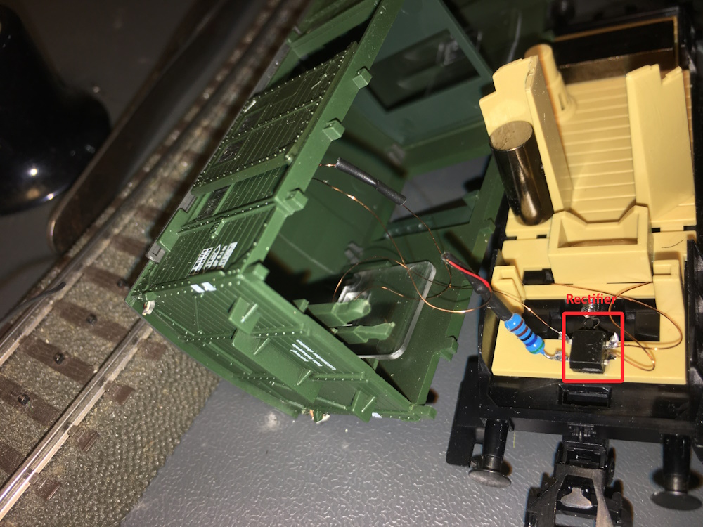

#5 Posted : 17 August 2024 10:50:42(UTC)
Posts: 3,573
I first had a rectifier bridge between the slider/conducting couplers, then the PLUS is connected to a capacitor. Last, the DC voltage runs through a resistor to limit the brightness (1 kOhm to 5,6 kOhms
Here is an example of illumination of a German caboose (Begleitwagen) using SMD (Surface-Mounted-Devide) full bridge rectifiers
Wiring using enaled wire
The result gives this
All using ultra-small pre-wired LEDs all purchased on Internet (very cheap)
