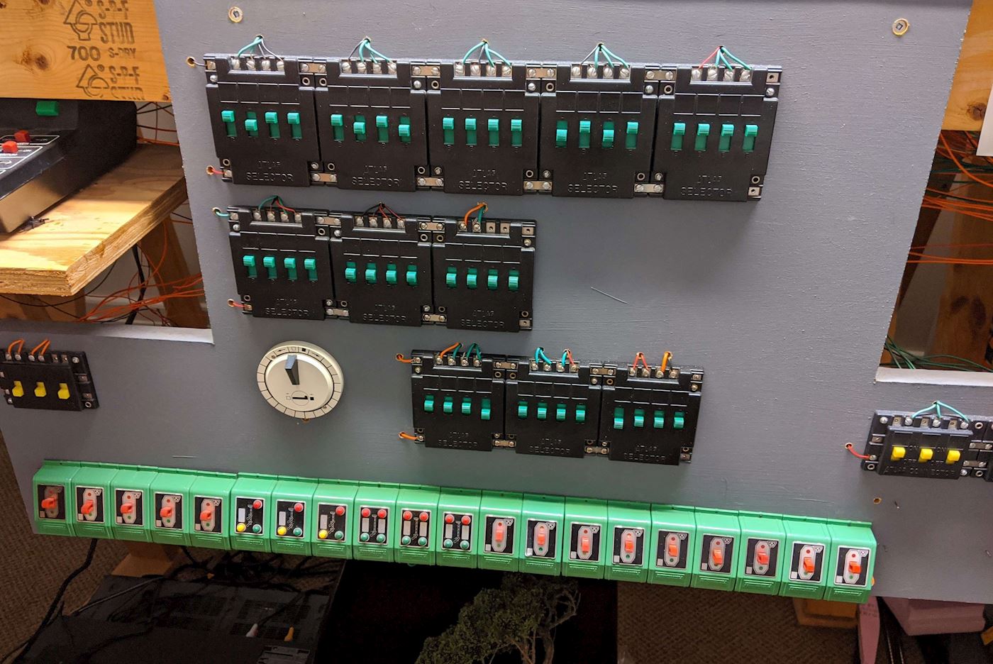

Outputs on my layout
(each of these red or green squares represent an output to start a tour, lock or unlock a fonction, etc
Sorry there as so many more possibilities that you may get bored
Thats all for now
