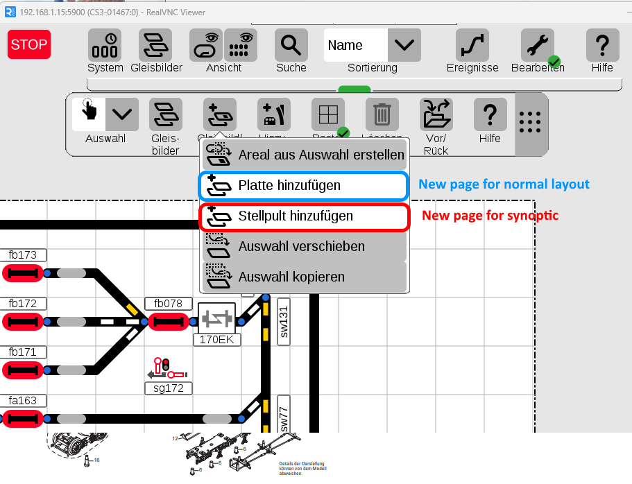

For Märklin there are 2 types of pages
If yes this is how you create them (normal layout page or synoptic page)

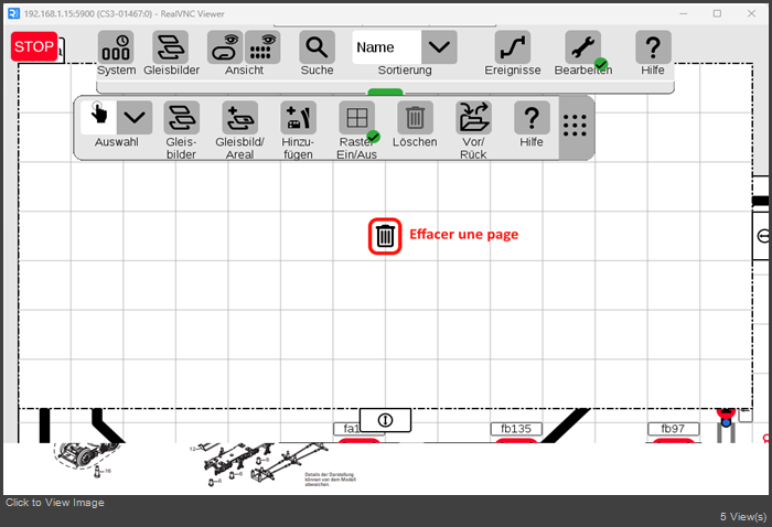

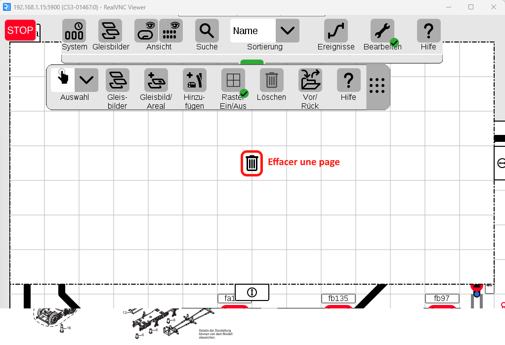

How to delete a page?
- select the page
- delete all items contained in the page
- then a garbage can is displayed to delete the page

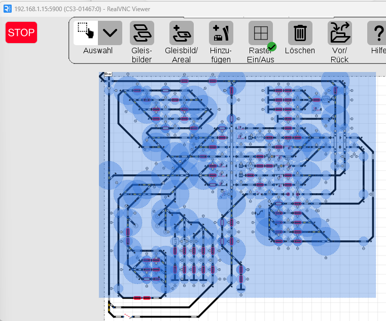

How to copy a page to another?
- select the page you want
- set the selection mode into ZONE
- zoom out to view the entire layout
- select the zone to copy
