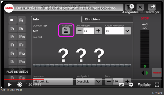

Regarding the non-MFX locos addresses, the easiest is to:
- pose the loco on the track ALONE
- set the loco zone into edition mode
- select add a new loco and select either MM2 or DCC and enter ANY address
- the next screen will include a key to FIND the loco address. Push it and you are done (below circled in pink)
