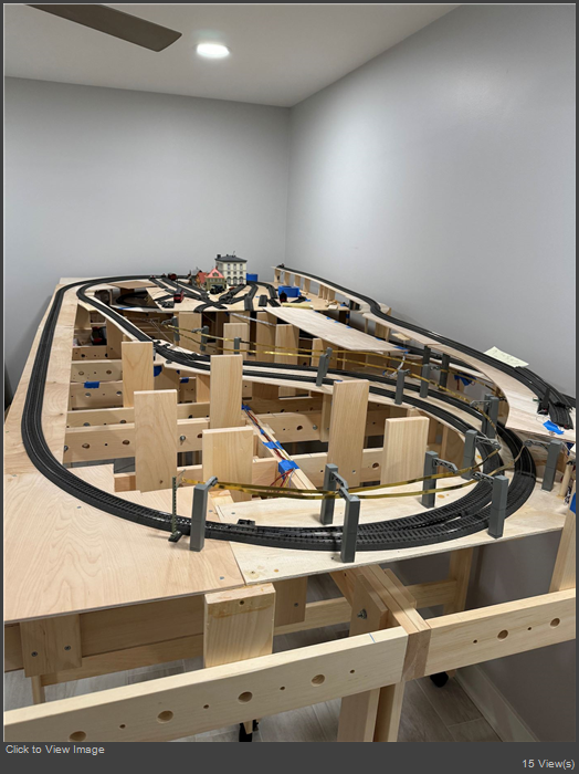

Hi I am in the middle of building this layout and having some challenges with catenary transition in shadow station / tunnel areas.
I would like to run with pantographs up and will have more than enough clearance to run e-lok's with pantographs in the tunnel / shadow station areas (already tested).
As you can see I started with Viessman 4195, but not happy with it at all and in the process of removing it.
Does anyone have any practical examples that would allow the remain pantographs up in the tunnel and then slope down and transition back to normal marklin catenary.
Thanks!

Hello sforugby,
I did not attempt to use a transition catenary.
With my C track layout I continued the standard Märklin catenary through the tunnel area, which is about 2.5 metres (8 feet) of curved R4 and R5 track.
But I took extra precaution inside the tunnel by using shorter catenary sections than Märklin specification on the curved track.
That made it stronger and not so likely to get shifted.
The Märklin catenary is extremely robust and I have never had any problems running pantographs up for 14 years now.
I do have to make occasional adjustments to a few mast outriggers to suit a new loco.
This is where the pantos are not quite level crossways on the loco, and they can foul the outrigger.
Here's an example at 23:37 of this video.
My Layout Build | Märklin CS3+ | K-track | Merkur | Viessmann | LDT | iTrain | Modeling primarily DB EpIV-VI

I might not understand your question, your intentions, or both.
Do you run live catenary? if not, why do you need catenary in the tunnels? just attach a wire at an angle from above the extended pantographs and this will push them to the correct height of the catenary.
