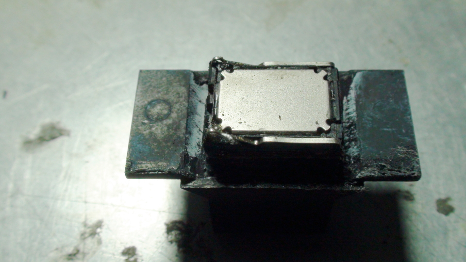

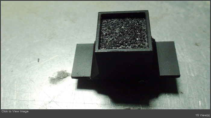

Well there has been another update: I've added a Roco 4 pin electrical coupling which wasn't the easiest way to do it., I had a careful inspection and found near the coupling shaft 2 holes which I was able to put 2 wires through, than superglued the wires along the metal boiler (part of the frame) and than connected it to the 22Plux sound decoder, I also fitted a cube loudspeaker into the coal reservoir, unfortunately I've connected the wires to the wrong Aux function but this is not a problem, just unsolder the wire and re-solder them to the correct Aux function,
#7 Posted : 24 November 2024 18:26:24(UTC)
Posts: 14,911
Here are some pictures how I did it.
