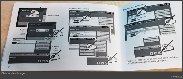

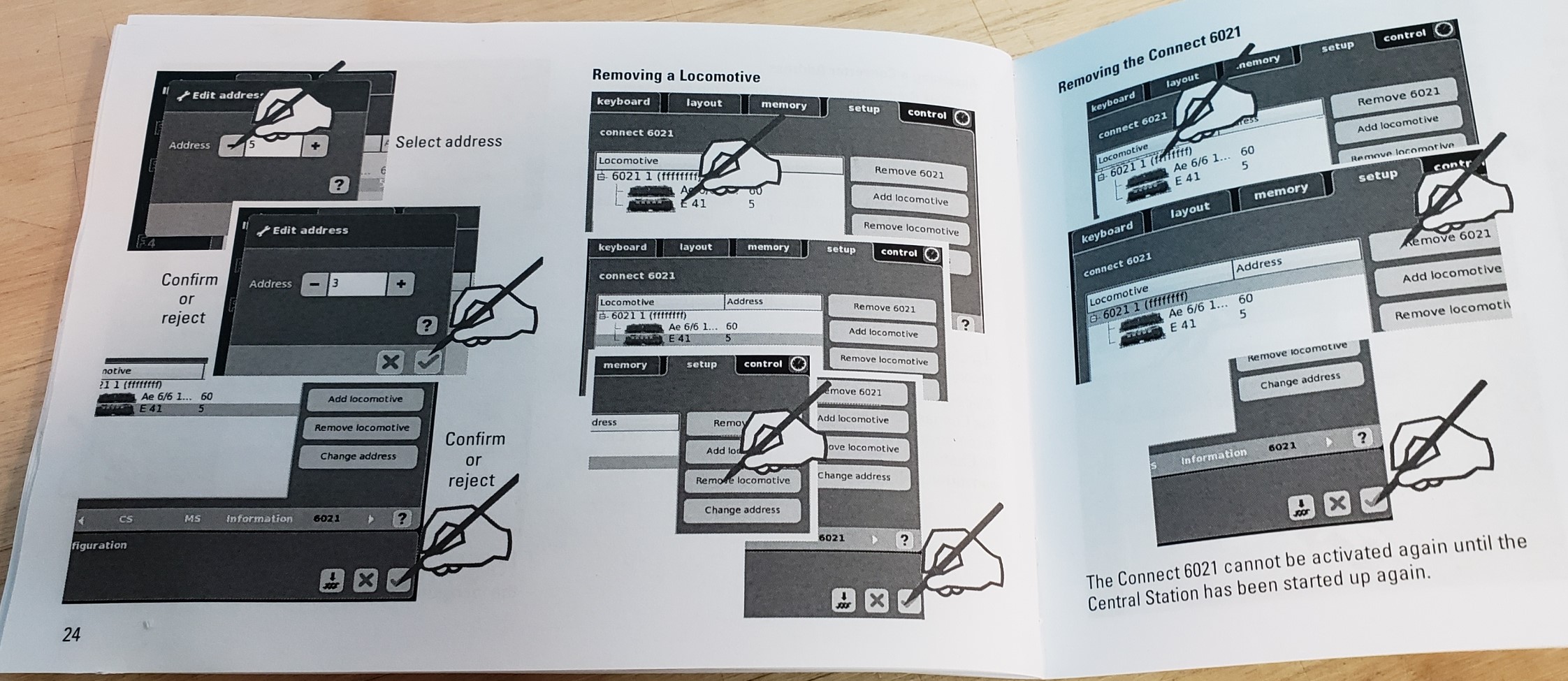

So I re re re read the 6021 connect manual and found a note at bottom right.
The note is under the "remove connect 6021" instructions, but I suppose it might be meant to apply to all
operations prior to that as well? I guess that's what I'll live with, which is better than it being buggy.
