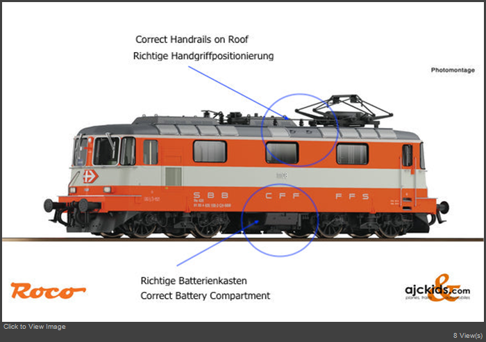

I had a chance over the past few days to do a lot of catching up and I have been dismayed by some of the posts about the new Roco Re 420 (Re 4/4II) on Drehscheibe and Stummi Forums:
https://www.stummiforum....xpress-erste-Bilder.html
https://www.drehscheibe-...en/read.php?010,10673214

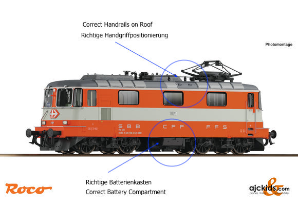

It seems as though there is a significant problem with the rendering of the model.
One of the posts describe how the two hand rails on the side of the roof are incorrectly positioned. Another post goes on to mention that the battery compartment (the box which sits between the bogies) is inverted. The author describes how he had to modify the locomotive shell to get the shell to sit properly in the opposition direction with the battery compartments properly aligned. I presume that the battery compartment is a part which can be detached, but I am not certain it can be mounted in the other direction.
Thinking about these two issues, it occurred to me that both are symptoms of the same mistake. Neither part is falsely positioned. Where somebody at Roco made a mistake is that the pantograph and the roof details were added to the wrong side of the model during the design process or during the mould making process. I don't know how this affects the power feed from the pantograph to the PC board (if this exists).
In my opinion, the only way to correct this flaw would be for Roco to replace the shells for all customers who have ordered this model, so that all the details appear as they should per prototype.
Would this be a deal killer for you or would you accept it as is and just run it, even though it is visibly "off" from all of the other Re 4/4s that Roco has made?
I have contacted Roco and I wait to see how they respond. I was really really looking forward to this model but I'm kind of asking myself whether it is worth the $450-500 at this point?
The original mockup of the model as it appeared on the AJCKids site in early 2023: https://ajckids.com/cdn/...02_580x.jpg?v=1673370744
The model as it appears at release (Roco): https://www.roco.cc/rde/...8-swiss-express-sbb.html
You can see the AJC image with my comments here: Roco-7520002_580x Comments.jpg
For those who want to dismiss this as "Nietenzahler" nonsense (Nitpicking), I just want my models to match and for a model that costs 100% more than the older versions, I expect better.

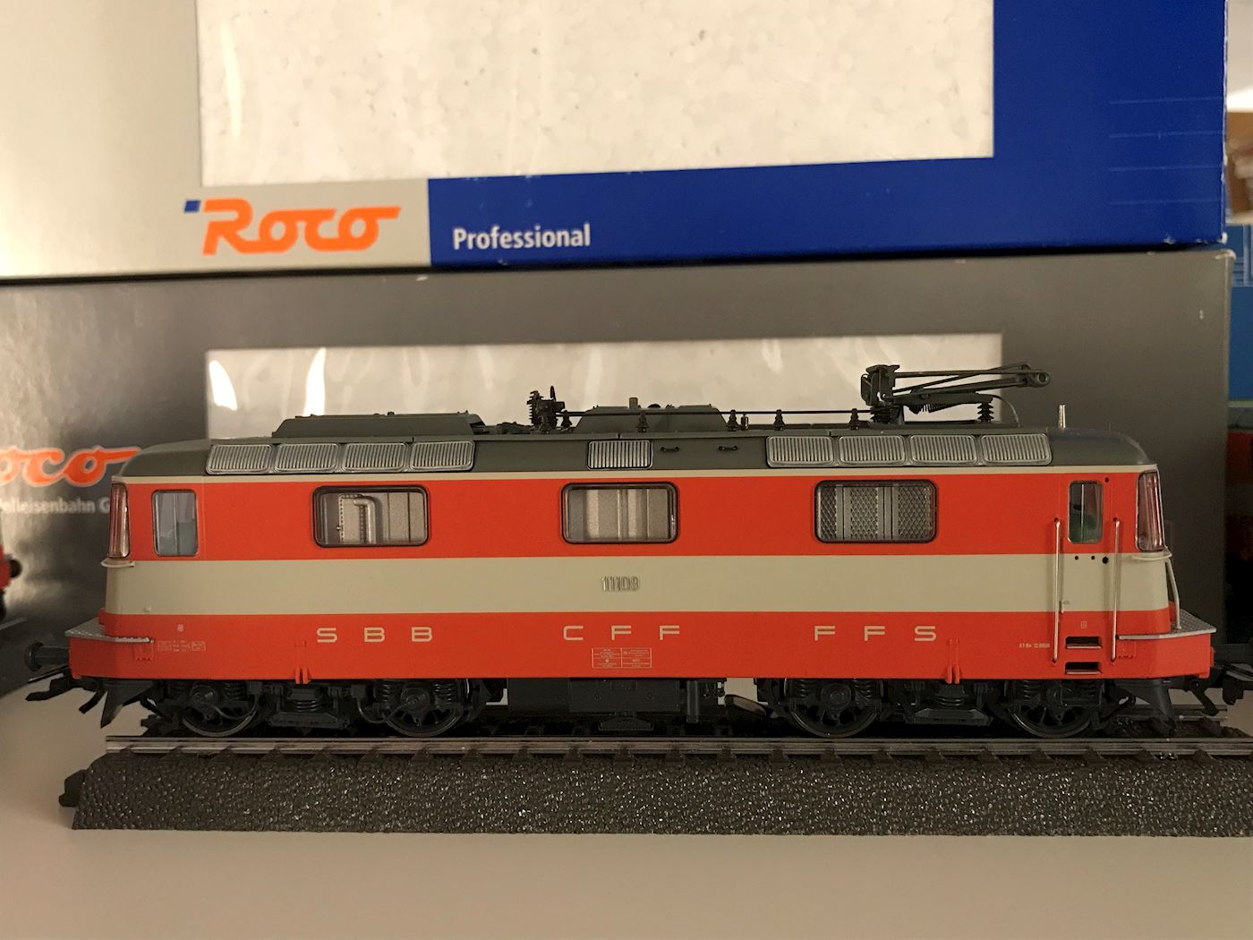

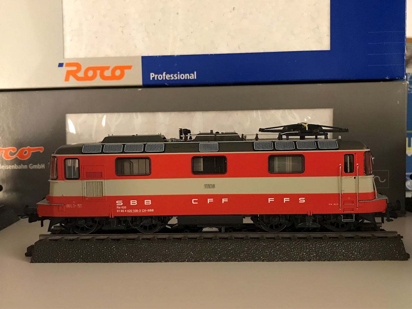

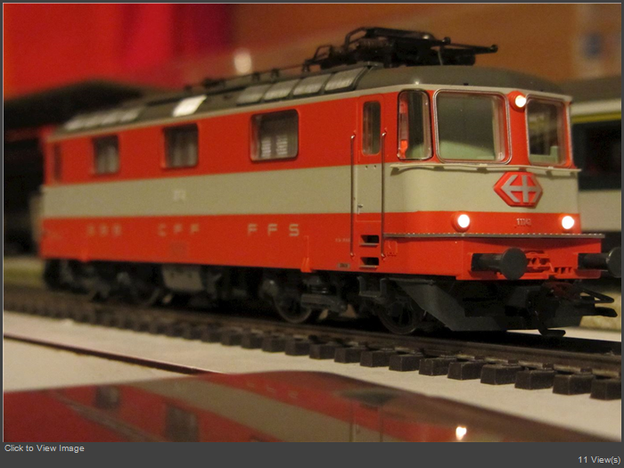

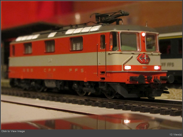

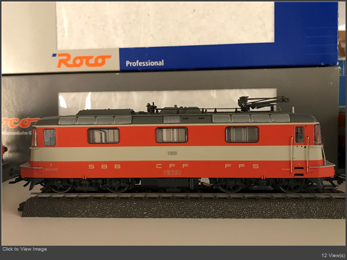

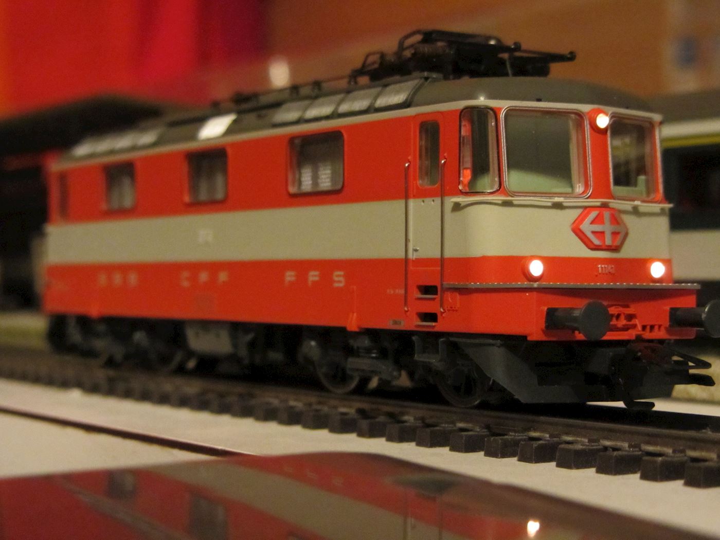

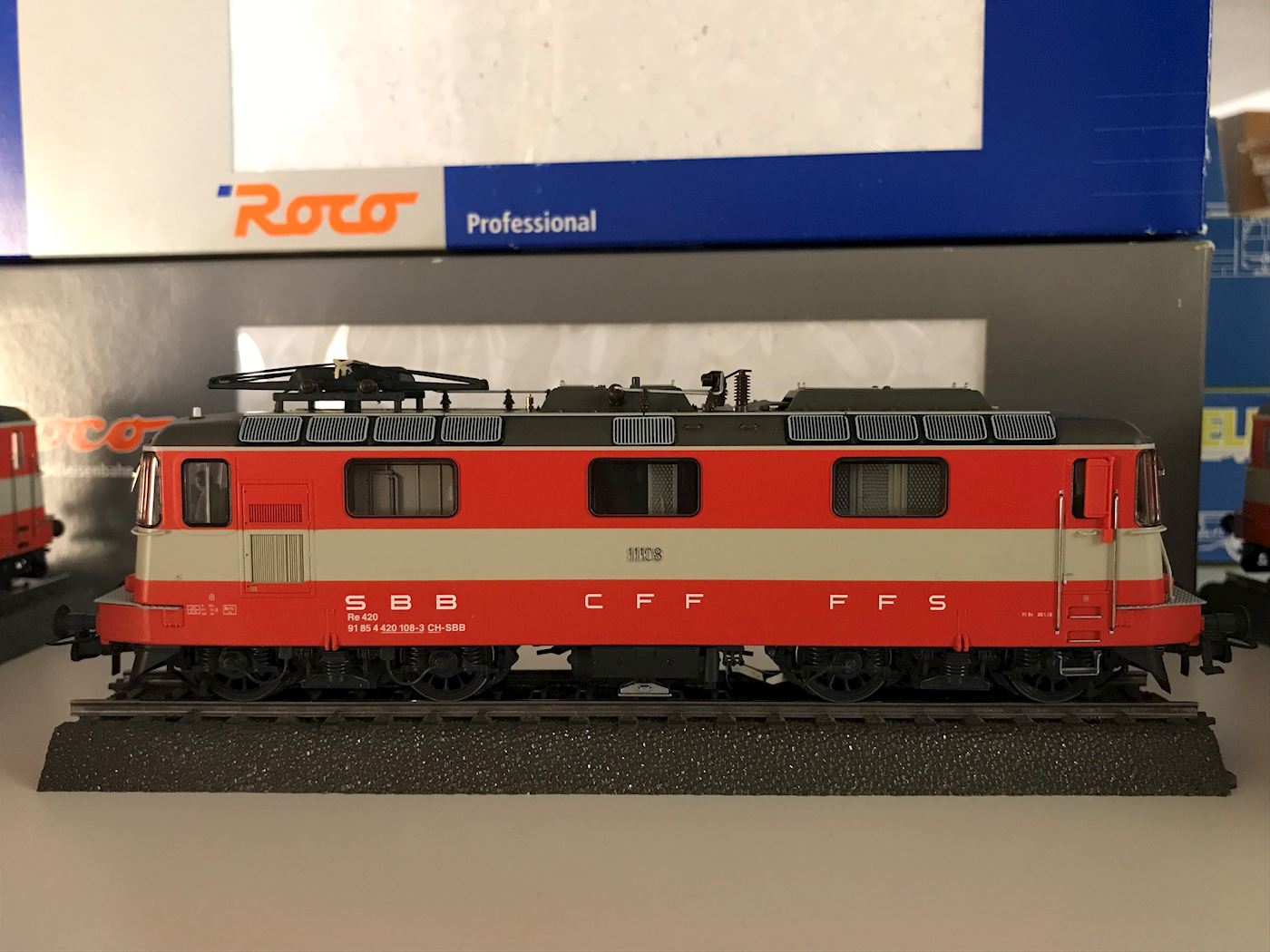

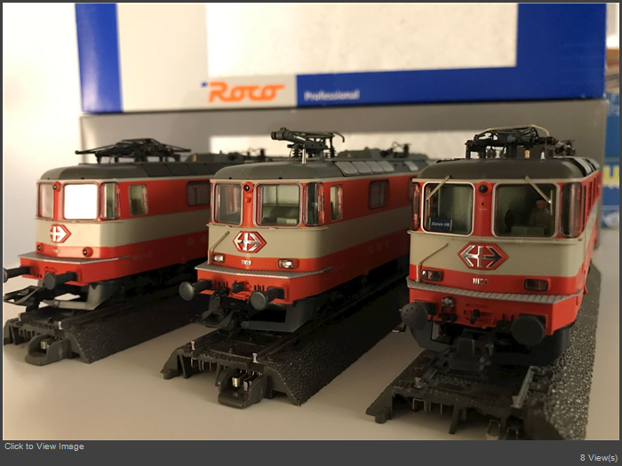

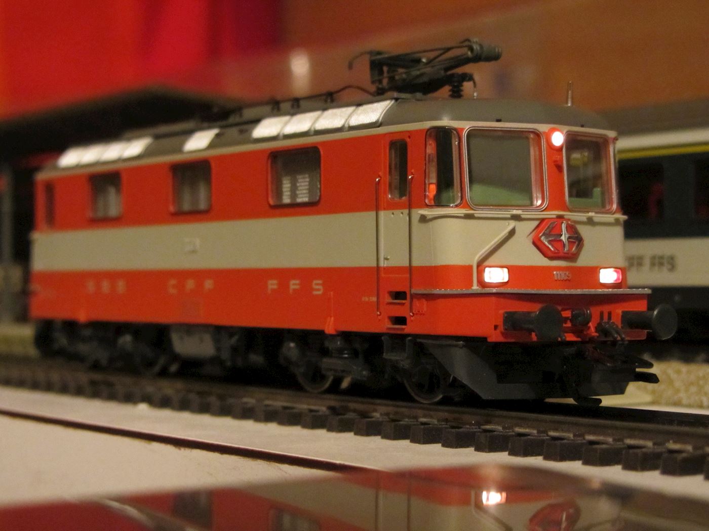

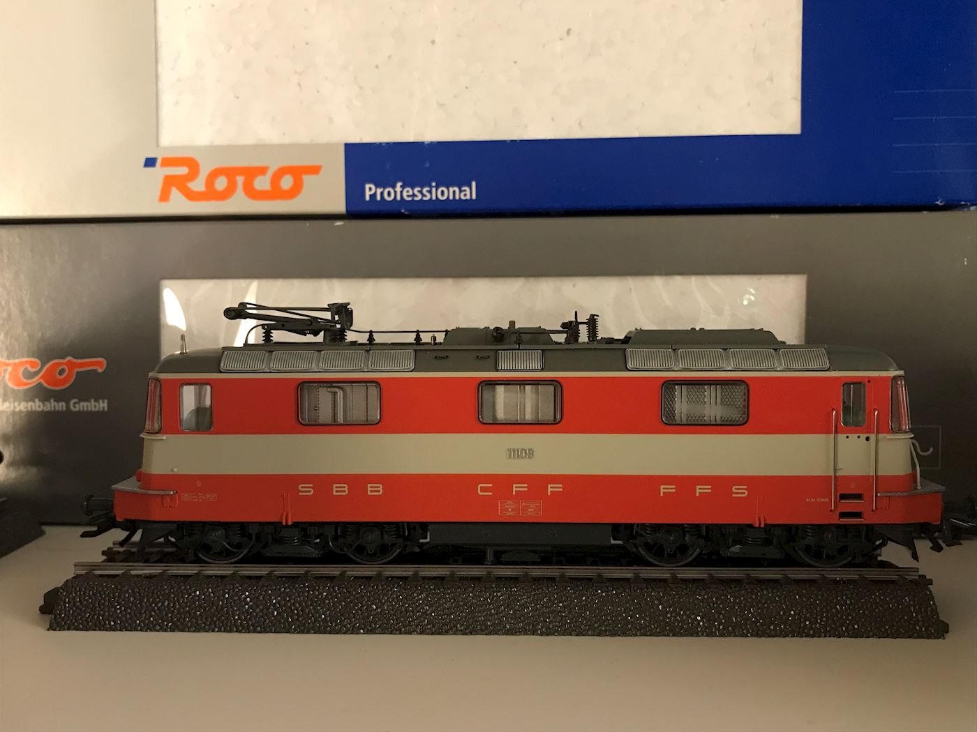

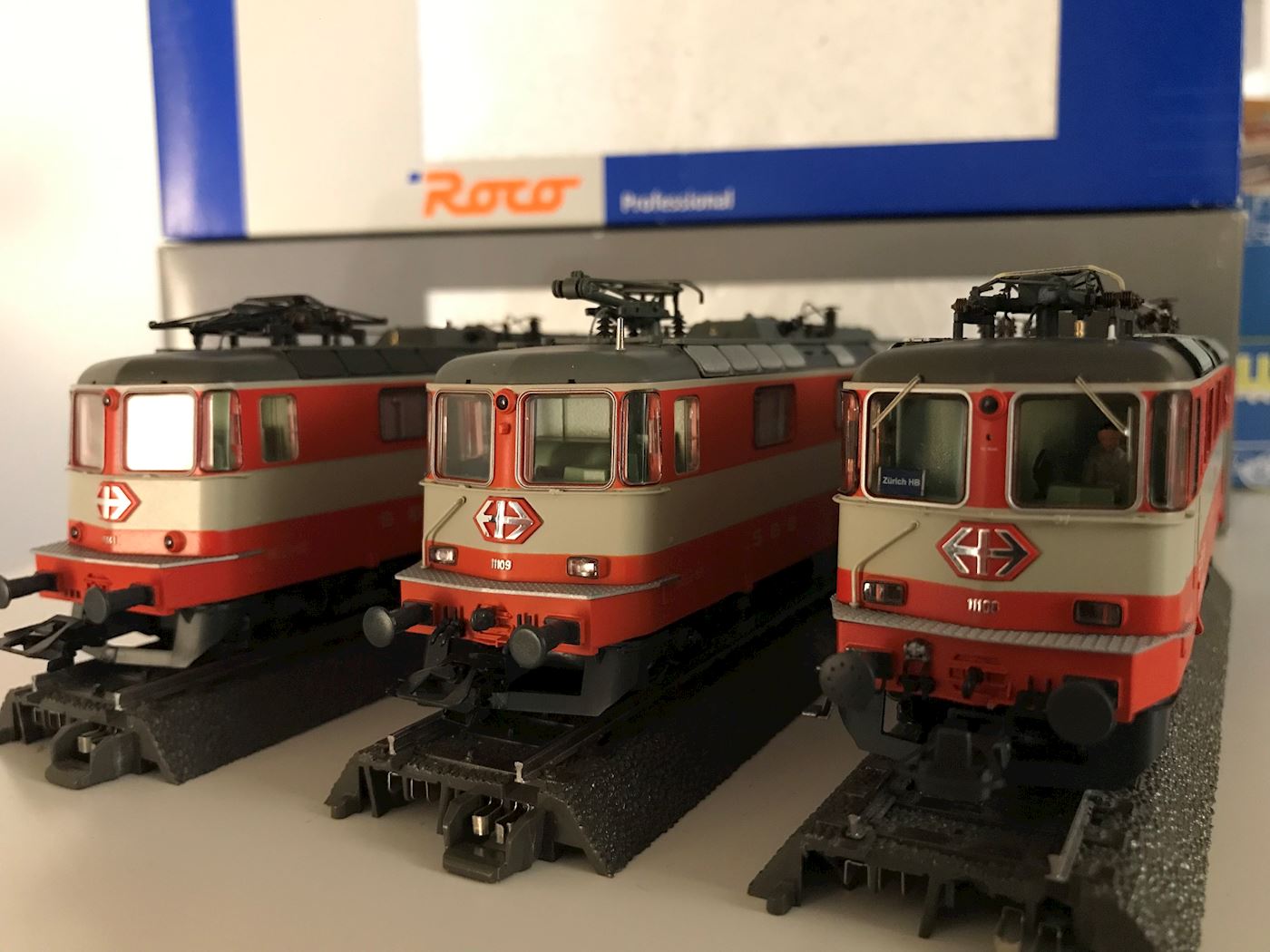

For comparison, here are my 69842 and 68690 models (68690 is the version with a single arm pantograph):
63842/68342 (11141)
62690/68690 (11108)

Outwardly, it may appear to be a simple issue of four little handrails that were drilled and mounted in the false position, but when you take a closer look at the model, the flaw is more serious.
The flaw is actually that somewhere during design/production, the pantograph and other roof details were applied to the model in an inverted direction. The result is the following:
1) Handrails on roof appear on the wrong side of the center vent
2) Battery compartments on chassis frame are inverted vis-a-vis the prototype

Somewhere between the CAD design and the production of the diecast molds used to make the final shell, the roof details were inverted, meaning that the pantograph moved from cab 1 to cab 2 and the roof ventilators and wiring was rendered in the opposite direction. If you picture the pantograph as I describe, you will note that the position of the handrails and the direction of the battery compartment now appear correct. It also means that the slider would be correctly fitted to the bogie with the pantograph.
Here are my Swiss Express models (69842, 68690 and the new 7520002):
7520002
68690
The flaw becomes very noticeable when the locomotive is alongside other models of the same series and I just happen to have 10 other ones.
