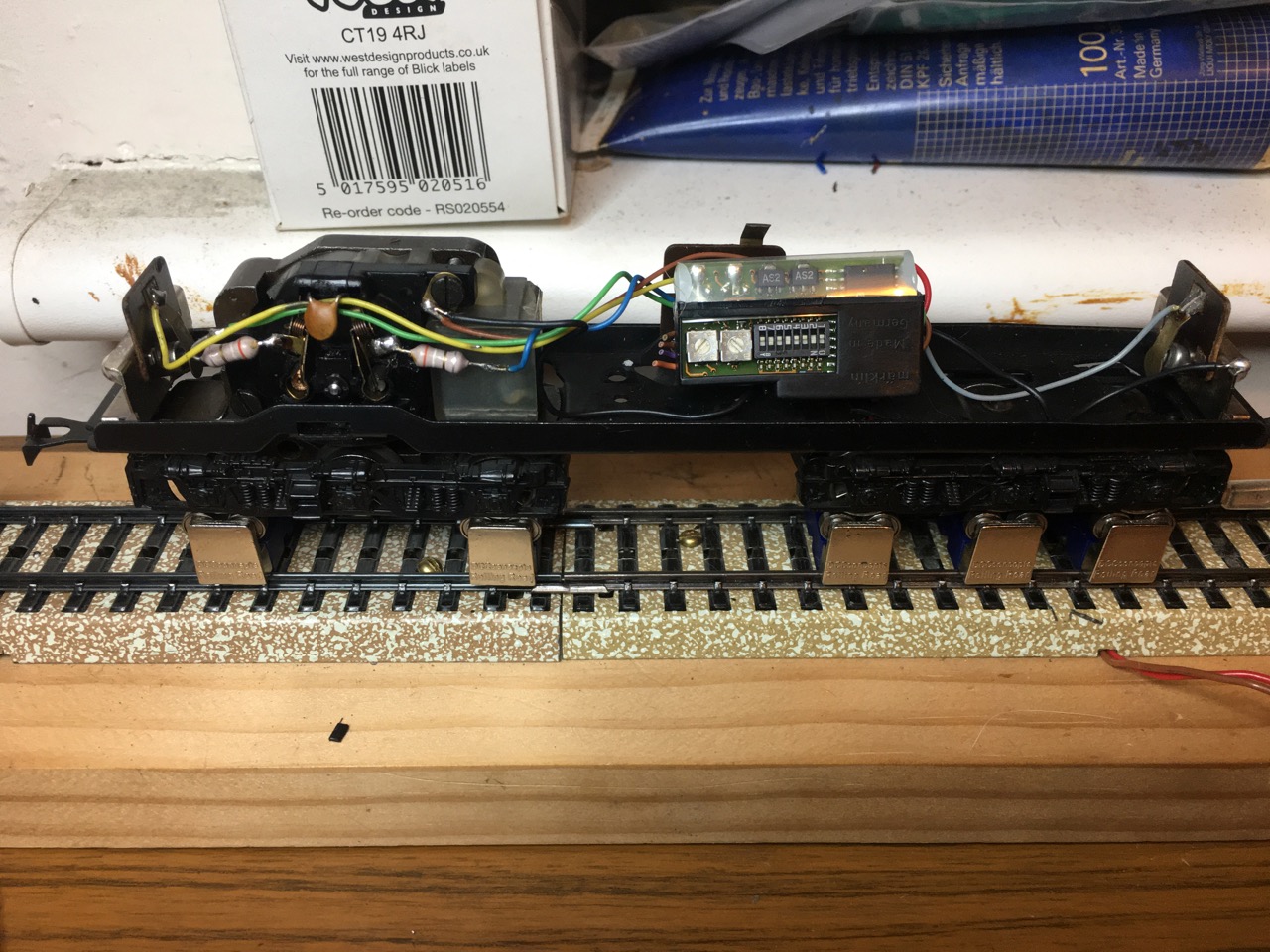

I have an NS1200 electric loco fitted with the LFCM. It has what looks like a 6090 decoder in it.
I run in analogue mode but this decoder had been installed by someone in a previous ownership.
The loco runs ok but seems a bit slow. It's not the motor bogging down as the motor runs fine by itself and also does not get too warm after a lengthy run.
Is this the decoder keeping a bit of voltage 'in hand' as it were in order to have a bit extra for the load regulation? I am making the assumption that load regulation works in analogue.
The decoder has two little potentiometers on it which set the max speed and acceleration/braking when in digital mode. Should these have any effect in analogue mode with this decoder?
I have other locos with the potentiometers on the decoder and they do make a difference in analogue - apart from the braking obviously.
I have tried altering them on this decoder and it doesn't seem to make any difference whatever position they are in.
I would ideally like to convert this loco back to original analogue but I don't have a spare reverser or field magnet.
Thanks for any information or comments.

It was designed to run with the 5 pole c90 motor, and you have it running with a large flat commutator with a Hamo magnet. I suspect this is the reason for the poor performance.
You have two options as I see it. 1. Restore to analogue with a replacement field magnet and reversing unit. Or 2. Upgrade the motor to a c90 with the 60944 motor kit.
If you do option 2 you will get much improved running with smooth acceleration etc, and it will perform well in analogue..

Mike - I think you've hit the nail on the head there. If that decoder was designed to work with 5 pole motors that would explain the mismatch.
The loco would originally have been pure analogue. It came to me as you see in the picture. Looks like someone has done a quick digital job on it with what they had available at the time.
I do have a reverser circuit from a defunct Roco loco that was produced for the Marklin system. It simply provides a DC voltage for the motor and has a relay to reverse the polarity when it recieves the overvoltage pulse. That would probably work ok with the motor as it is.
However I'd prefer to keep it Marklin and ideally get it back to original. I think I'll keep an eye out for the appropriate AC field magnet and a standard Marklin reversing unit.

I have put the Roco reverser in now and it works well. The loco now runs at a speed more in keeping with the other locos.
At some point I'll put in a wound field magnet and Marklin reverser but I don't have to rush to find the bits.
