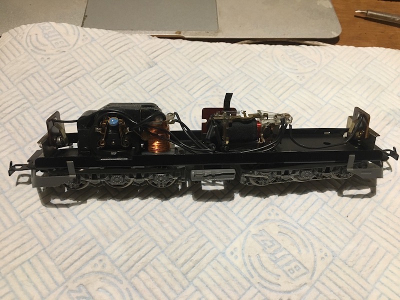

Unfortunately I can't see how to post pictures on here although I have just taken some of the wiring. It appears that you have to have the pictures on the web first.

Right - another attempt at posting the pictures of the wiring...
Overall picture of the chassis...

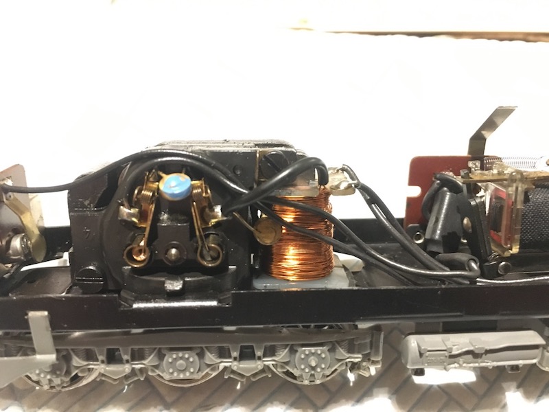

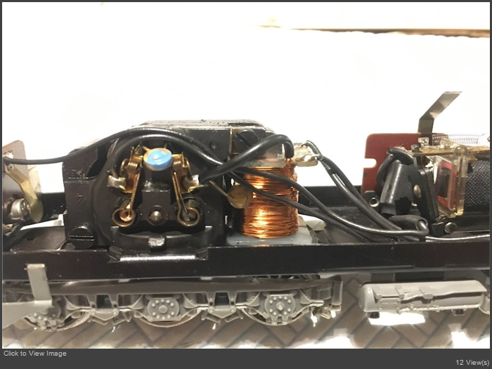

Close up of the motor area...

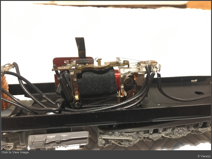

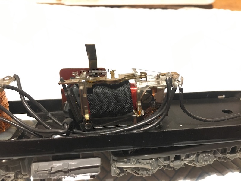

Close up of the reverser - you can see the two wires attached to each of the solder tags, the normal ones for the field magnet coils and the extra ones feeding the bulbs to make the lighting directional.
I hope these help a bit. If I were re wiring I would keep the lights conventional i.e. not directional.
