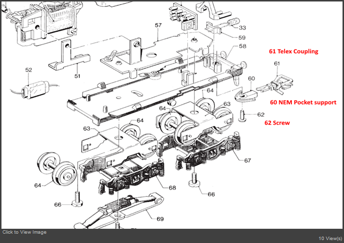

Looking at the exploded view diagram (see below) it looks like
- the is a NEM pocket support
- a standard Telex E177993
- a screw (not referenced
Apparently the drawing is not relevant (no thick axle)

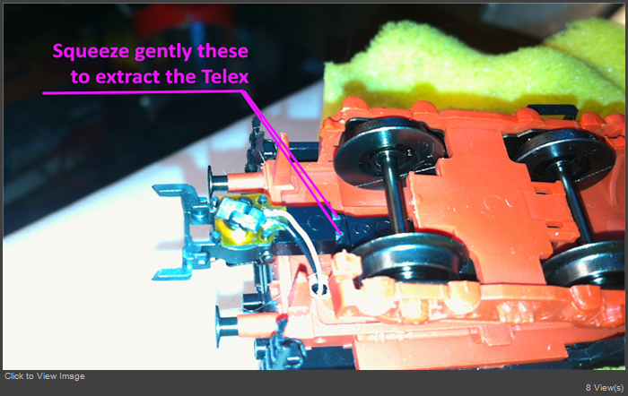

I think a simple approach is to leave the NEM pocket in place but extract the previous Telex by squeezing gently the two extremities protruding out the the NEM pocket with a long-nose pliers while pulling gently the Telex. No brute force will do as these parts are fragile

Hi, John, thanks for your fast reply, but the 37921 with its telex coupler DOES NOT have a NEM box as its "family members" have and the explode drawing shows.
The telex coupler is a full part that can be seen in: https://images.app.goo.gl/pn6FHEzJ6H7fff8t8 and the 210137 that is inside the tender and connect to the coupler, can be seen in 26536 BR44 parts list, where, by the way, the "Rastbolzen" 218951 can also be seen.
Question is still how the 210137 and 210133, that are hooked using the 218951 can safely be separated?
