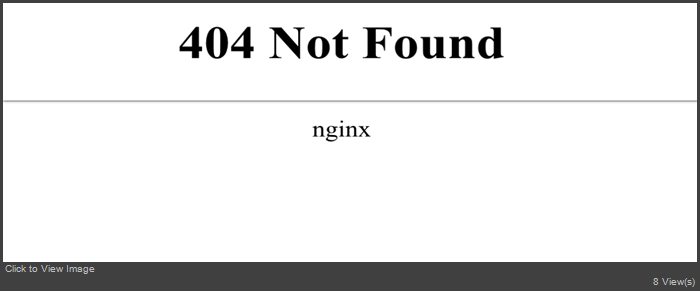

Hi everyone,
I wanted to see if anyone else is having issues with downloading the latest CS3 update that was released early December 2023z
I have a CS3+ and use the Rocrail software.
On the download section of the Marklin website, I go to the CS3 update section, ‘check’ the licensing agreement and click on the download.
What happens next, a new page opens with the following error:
Has anyone else experienced this issue?
Previously I would just download the file on a USB key and then plug it into the CS3+, it worked without any issue.
Also, has anyone had any problems with the CS3 connectivity to Rocrail after the update?

Its reported to Märklin but they are in no hurry Huh
The english MSW page is also wrong but it seems the language is not of important so use the german... same files.
