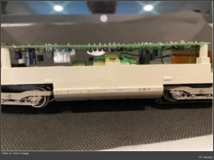

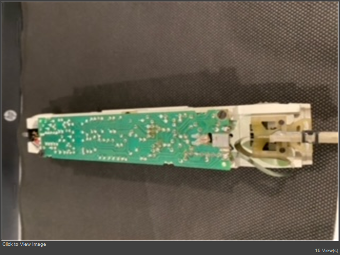

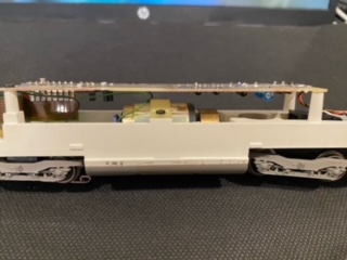

I have a Marklin ICE unit that was mislabled as digital and is analog. The unit is either a 3370 or 3770 serial number E69412. I know it's analog because I removed the shell and there's no decoder inside. What Decoder wouuld anyone recommend for this unit. The large curcuit board is 124 x 27.6mm. Thank you.
Here's a couple of pictures of both end units. image0 (2).jpegimage1.jpegimage2.jpegimage3.jpeg

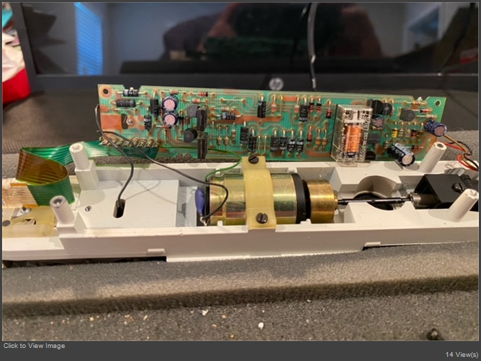

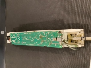

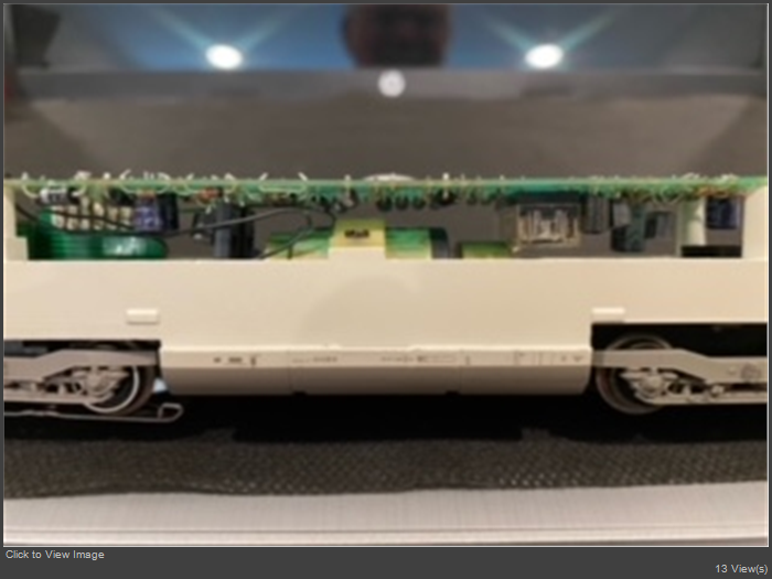

Thank you for the replies. I've attached pictures of the interiors. Your thoughts and suggestions are greatly appreciated.

The pictures are showing indeed either a 3371 or 3671 (the last one being the digital version with a 6080 decoder).
Both engines should have a motor inside, but your pic's are to hazy to see if the board has dip-switches on it to see if its digital or analog.
Not sure if the Faulhaber motors accept "normal" decoders as easy as the standard old DCM, etc... motors, I have no tinkering experience with those BigGrin

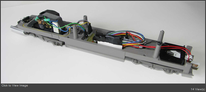

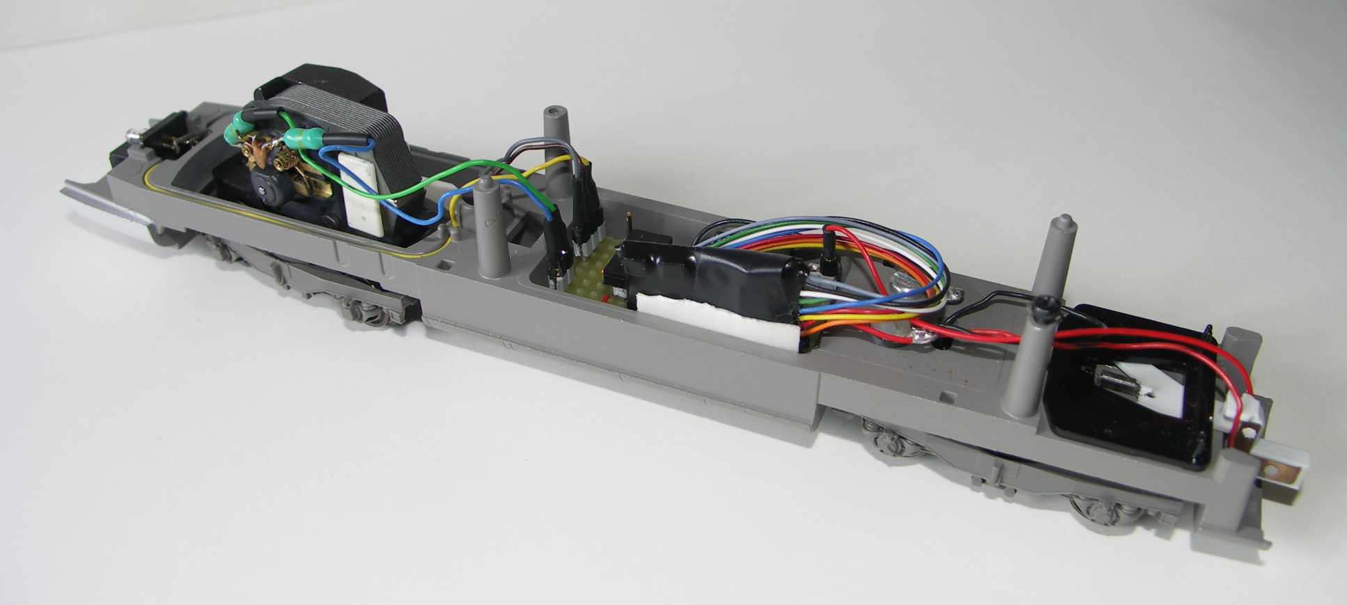

Guys I think this is the Ice Experimental #3371 or #3671
https://www.ete-ene.org/digitizi...xperimental-number-3371/
#3750 for example is with the permanent magnet. This version has the can type motor from memory

#13 Posted : 23 December 2023 20:40:00(UTC)
StanN
Joined: 16/02/2023(UTC)
Posts: 10
Location: Florida, St Augustine

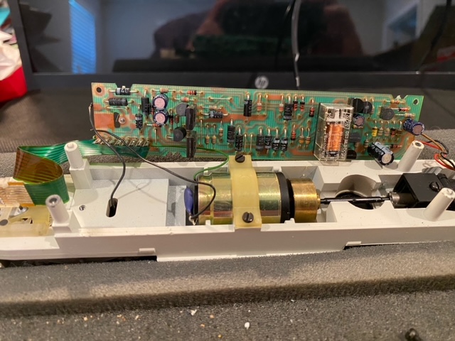

Here's an updated picture of the board and motor. It appears that I was a victim of the bait and switch.
thanks 1 user liked this useful post by StanN

No dip switches on the board, so you have a the analog 3371 ICE
You could still make it digital with the special kit as described in the video previously posted, or with a more standard current decoder and some soldering work....

The serial No start with Exxxx that means analogue with electronic reversal unit,
THis is and the impression from the pictures of the PCB.
Digital conversion is possible.
You must use the follow
1. 60973 Decoder plate for units with two pick-up shoes
2. 60977 Decoder you can put the ICE sounds with the mDT3 software and 30971 decoder programmer or CS3
Is a very difficult conversion
Costas
