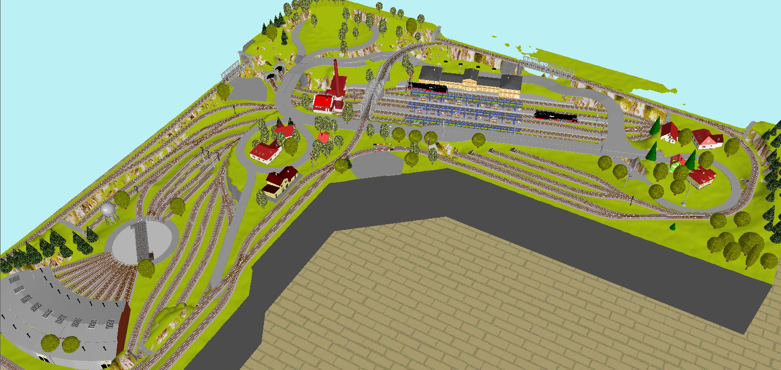

Here is my main level including Top (elevated) and main level (Main station)
Here is the bottom level 'Shadow stations)
And here is how the 3D layout looks like (Sorry, old Wintrack version)
And here is the result (I am not very proud of it but it shows the layout designIMG_4817.jpg
