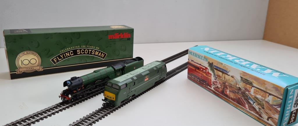

My observations on running 39968 Flying Scotsman on a C track layout are as follows:
1. Runs comfortably through curves from R1, standard and long turnouts, cross overs and double-slips. I have catenary and signals etc and there was no fouling due to overhang.
You should check for any fouling of lineside objects on your layout.
2. Standard curved points are mostly OK but if there is a slight misalignment at the joint with ordinary rail (vertical or horizontal) the front bogie can become adrift.
I solved the problem by (either method may work alone):
Firstly lifting the track joints a few mm (cardboard or plasticine stuff) due to a dip at that point.
Secondly increasing the tension of the spring between chassis and front bogie by removing/replacing - bending the sprung brass sheet slightly in two places.
The bogie then tracked well.
I also noticed deeper flanges on carrying wheels.
By my measure (which may not be precise), the front bogie, trailing and tender wheels have normal Märklin deep flanges (1.25mm) whereas the driving wheels are 0.7mm on this locomotive.
I would say the deeper flanges on the carrying wheels definitely maintain the smooth guidance through turnouts and cross-overs.
3. The operating sound at slow speed replicates the 3 cylinder exhaust precisely, but at high speed it simply merges into one chuff which is too short and too long a space between chuffs to be realistic.
My experience of hearing locomotives at speed (70mph in NSW) was that the exhaust was just one giant roar of hissing with hardly a beat detectable.
I guess reloading sound is achievable if there is a better option. In my early CS1 there was an option to change the chuff rate and spacing, but the CS3 does not seem to offer that.
4. There are multiple options for lighting, most take time to figure out from the CS3 icons. My cab lighting does not work (i might not have figured that one out). No big deal for me because I rarely run my trains in the dark and I cannot see inside my tunnels.
5. The smoke generator is brilliant - I reckon it went for a full 5 minutes (and the smoke deflectors worked brilliantly lifting the smoke well clear of the cab Blink).
Summing-up this is a breath-takingly beautiful model and I am glad Märklin took the time to offer it.
There are very satisfying sounds from the wheels and chassis as it flies through turnouts, cross overs and slips, probably due to the 8 wheeled tender.
One more thing - the headboard in blue at the front of the engine smokebox was only used if the engine was to haul the Flying Scotsman train from London to Edinburgh.
That particular train left London every morning at 10:00, and I believe the opposite train left Edinburgh at around the same time (not sure exactly).
Now for some HO scale British coaches.
I have added polls (Poll 1, 2 and 3 in separate topics) to gauge the interest in HO scale British models.
I have deliberately restricted the poll because Märklin have started with an iconic locomotive, the 39968 Flying Scotsman as it is in era VI.
Using 39968 as a basis there are 3 options in the polls which Märklin may consider to be design-able and sale-able.

I must say again that is a gorgeous model that looks far better in person than in pictures.
Agreed!
Picture of my Scotsman with the only other Marklin British loco, the 3073 Warship.
Agreed!
Well, maybe your only two BR models, but there were a few more in the past. Just think about the LMS, LNER, and of course the Harry Potter- ok HP does not count at all.
Martin
#28 Posted : 20 January 2024 05:30:06(UTC)
The Harry Pothead train was Hornby made.
The other locos AFAIK are quite old models, older than me!
I was of course referring to more modern day models.
Sure, you meant the modern models. But even the 3073 is more than 50 years old. The ugliest model ever.
