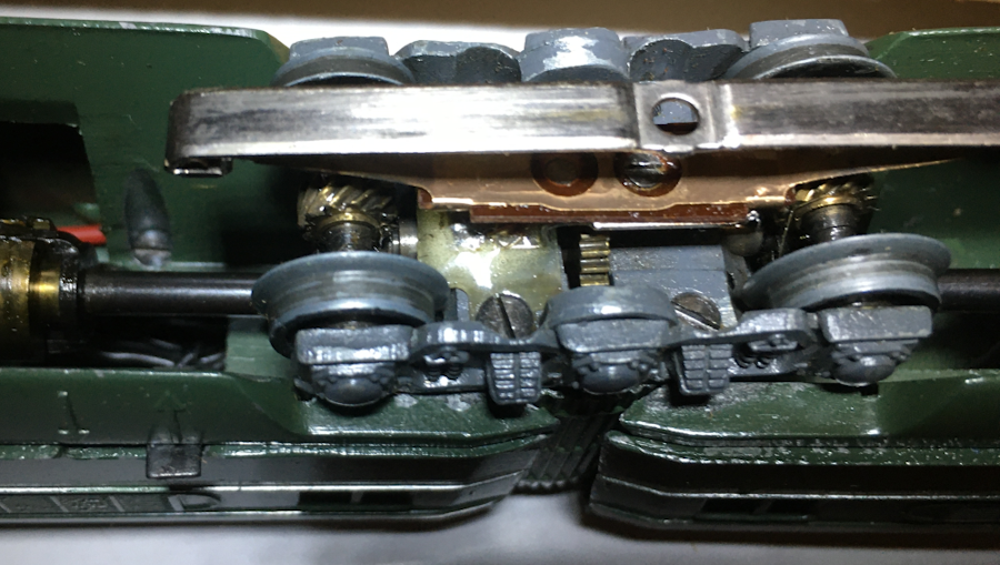

Spoon pick-ups wear rapidely and are expensive to replace
I went the other way by adapting a "normal" slider on a 1951 DL800 loco, of course without modifying any original part nor applying epoxy glue to those
