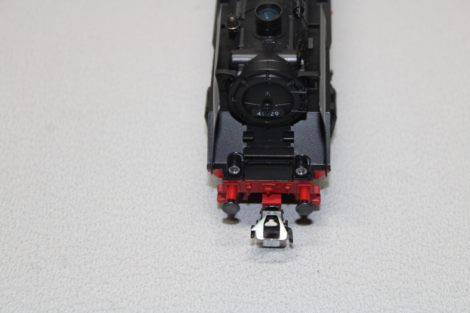

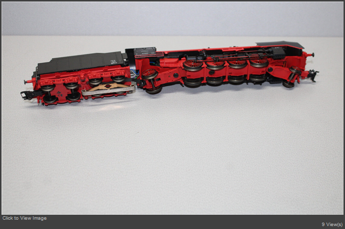

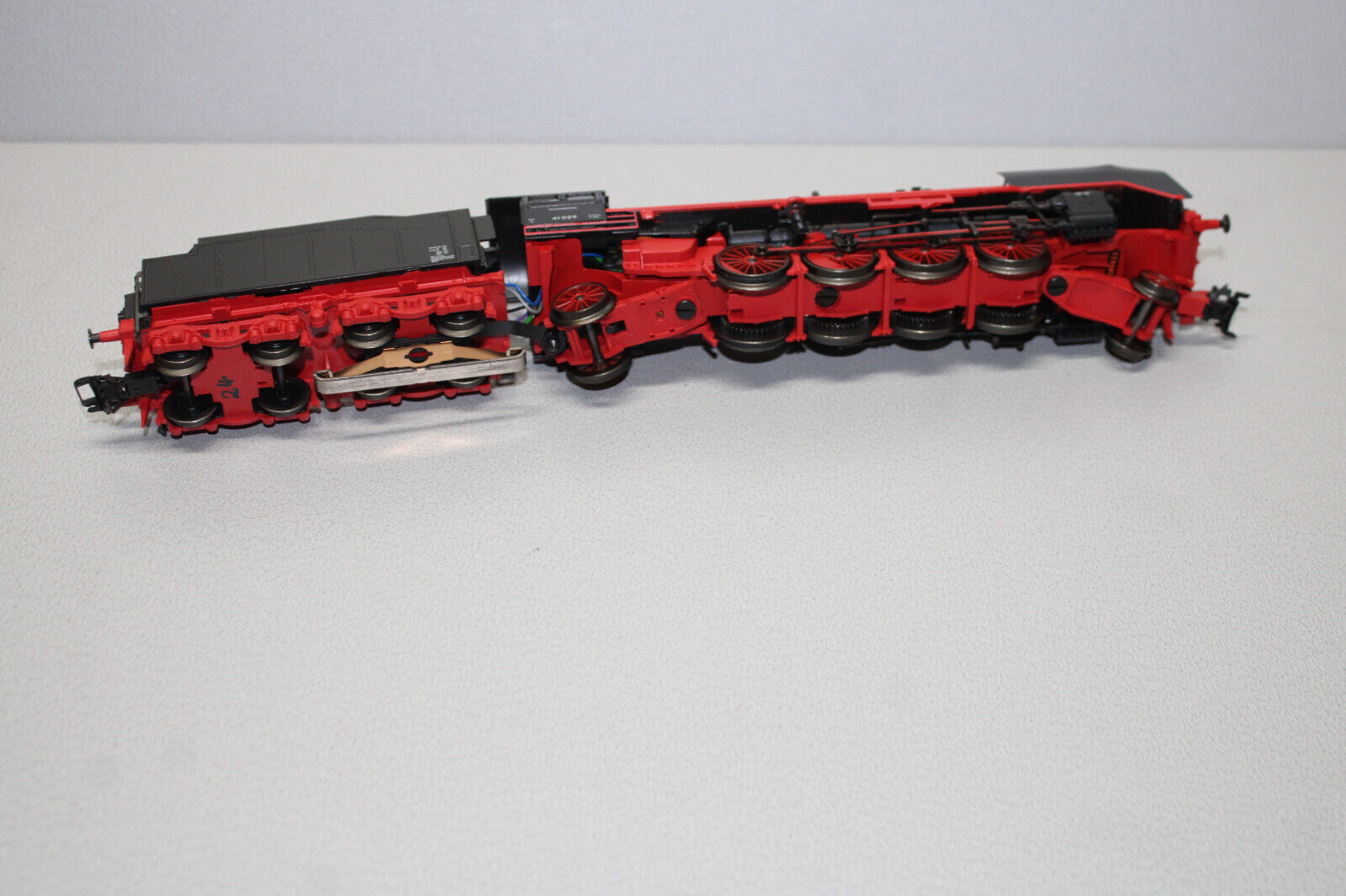

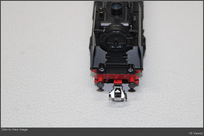

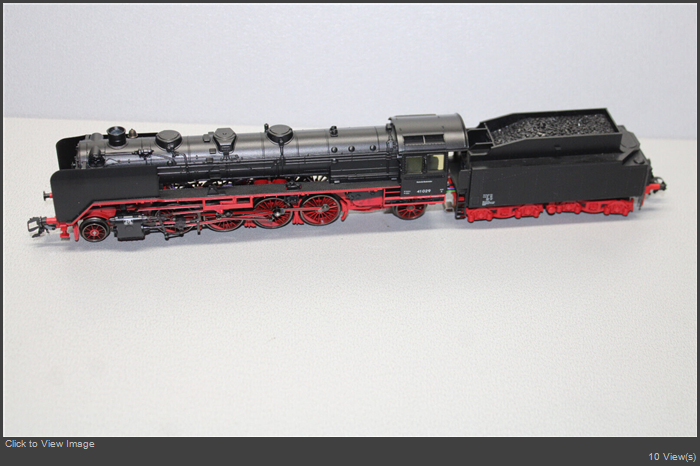

just ordered this BR41 029 Delta from eBay. The seller had no clue what the Märklin catalogue number is and I'd like to have it and manuals in my archive. Can anyone please help me with that?

#9 Posted : 11 October 2023 08:53:57(UTC)
Posts: 2,265
Hello Eino,
From Koll's Katalog one can see the Märklin Catalogue number for your particular
BR 41 road number (41 029) is 3082.
As noted here on this forum before, it came in Zugpackung 29815 and 29816.
It would seem to be Koll's version 3082.40 (detailed very nicely in Tom's 3rd Rail Wiki link)
Whilst it was made in 2001 and is Delta digital controlled, the inner mechanical parts of the loco should be the
same as the other prior 3082s, as also noted here. (Except of course for the delta digital unit and digital lights).
I also have the locomotive 3082 :
From Koll's description, I think mine is 3082.3 (1982-92) and was analogue.
My compatriots on this forum might be interested that it was purchased new by the original owner
in Australia from "Toyman" in Sydney in July 1983 for A$121.
I bought it secondhand from Peter at Narabeen ("Toy Collectables"), Sydney (business sold later to
"Train Trader" at Pymble, now closed) in October 2009 for A$269.
I have since converted it to digital, initially with a 6080 decoder and later to an ESU Lokpilot v4.0
together with conversion to a 5-pole motor, LEDs and a smoke unit.
I have copied the "manual" (folded up pamphlet) that came in the box with my loco and the images are
below. You will see the "manual" is not specific for the loco but generic for a Märklin steam engine, as
was the form in those days, there were not the detailed manuals for each loco that we see today.
You would probably find the exploded parts diagram more useful.
As you noted, they did not seem to open from the Märklin site referenced link.
Here is the exploded parts diagram :
3082_explo copy.pdf (191kb) downloaded 23 time(s).
Have fun
PJBigGrin
