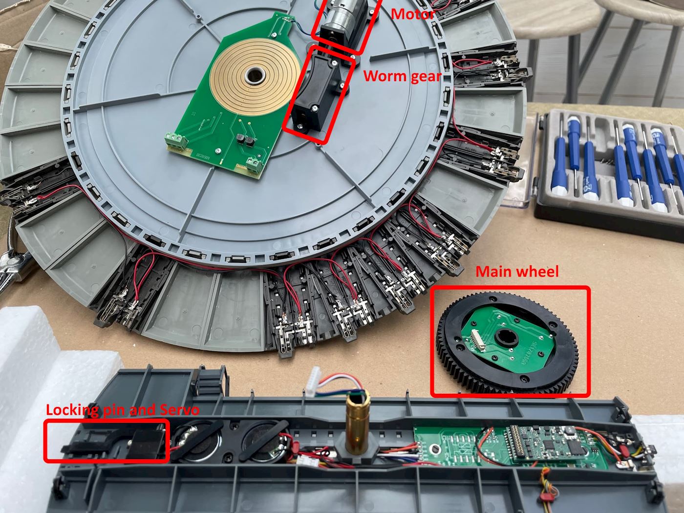

Just for you to know here is the 74861 once opened
Note: This is Julie picture in Forum 3 rails in France and NOT my picture
