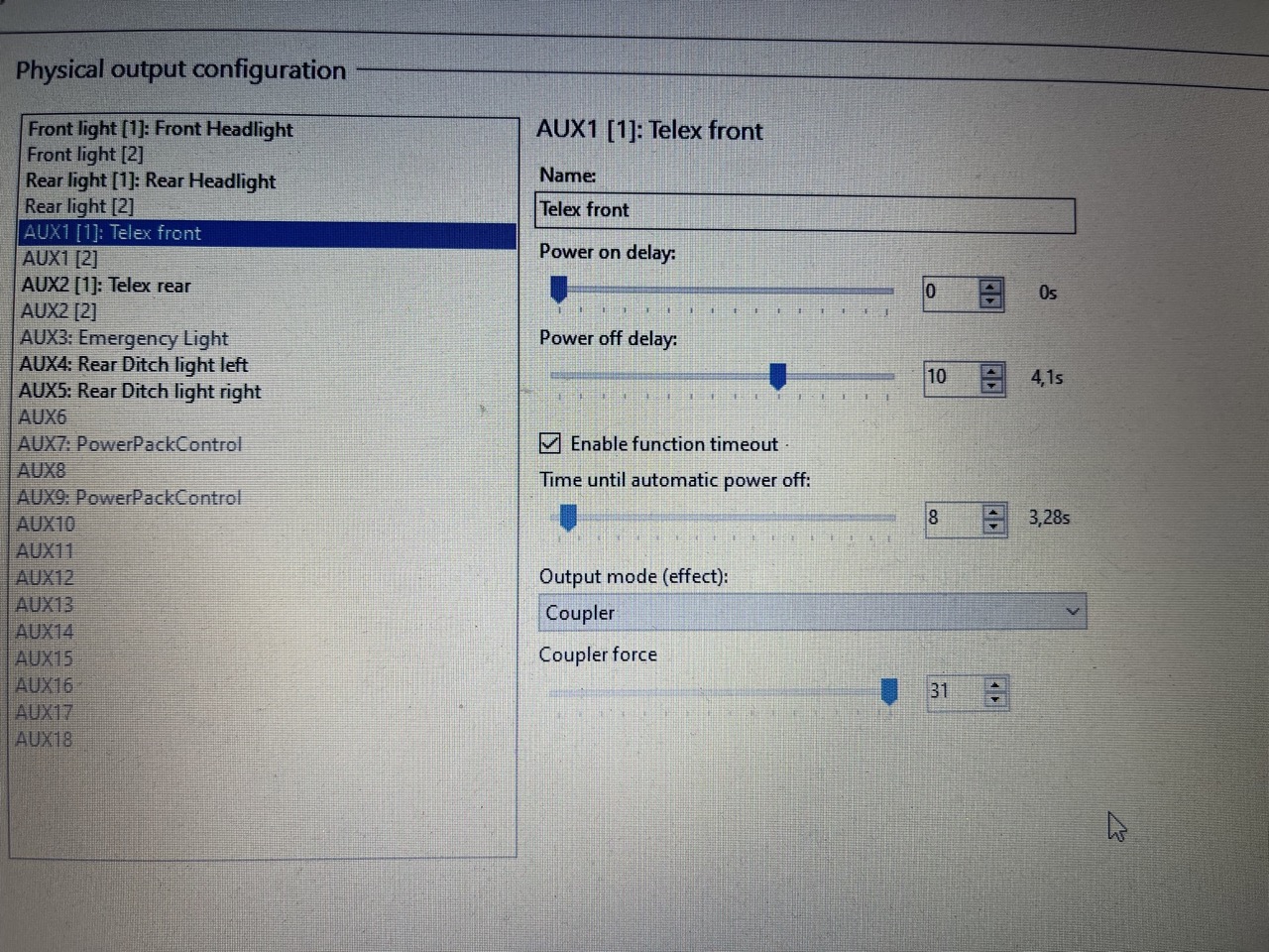

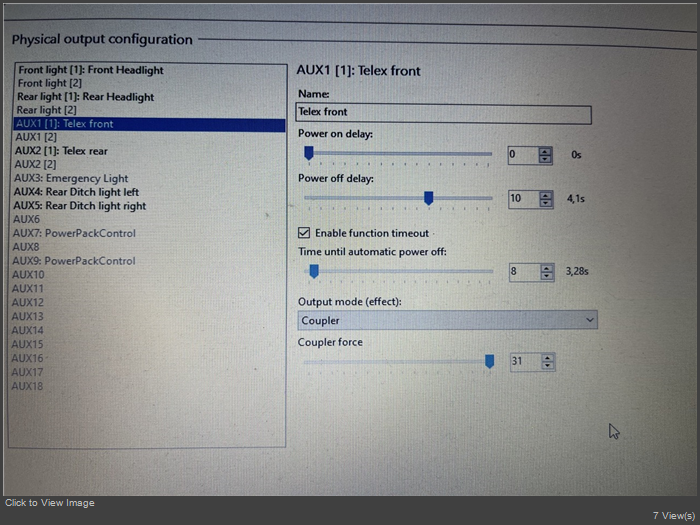

Hi guys,
You've previously helped me to setup modern Telex-coupler with mSD3 decoder. Now I'm in need of help with Loksound 5.
My problem is that even after the function "ends" and the pin is actually dropped in, the coupler gradually warms up. On Lokprogrammer's programming track it seems to be milder and I first did not notice it applies to it too, however with Mobile Station 2 the heat buildup is really fast.
Here's my setup:
Black wires go to U+, gray wires go to Aux1 and Aux2.
Here're screens from Lokprogrammer:
Also, in "Physical output configuration" why are there two entries per output? [1] and [2] ?
Thanks again,
-Eino

#3 Posted : 14 September 2023 21:31:57(UTC)
Posts: 15,542
Originally Posted by: einotuominen Go to Quoted Post
Also, in "Physical output configuration" why are there two entries per output? [1] and [2]?
This allows two different settings.
With lights, this can be used to simulate long-distance headlights by making a "dim" and a "full" setting for the lights.
I don't see a use-case for Telex couplers.
