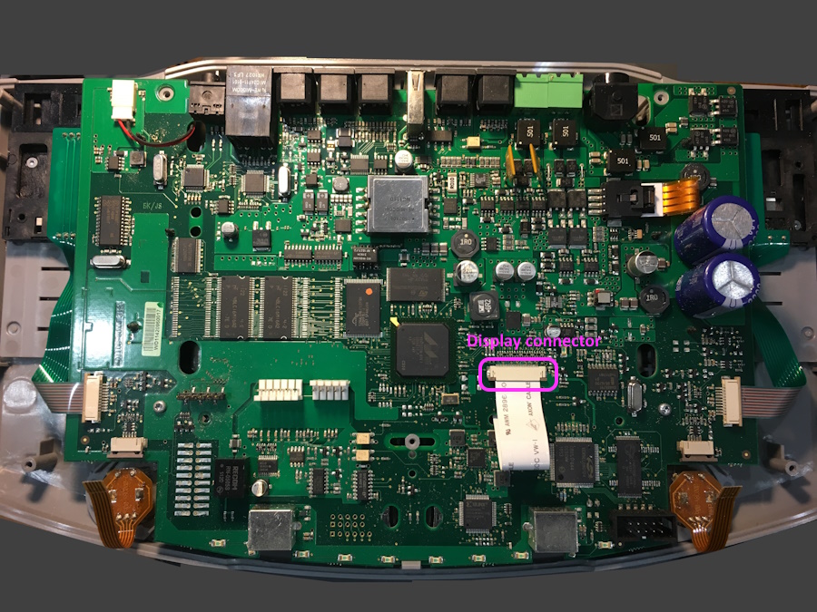

Hi guys
I’m having a blue screen on my Marklin
CS2 60213
Why is this so ?
Can I have the screen replace
or it’s about the setting

Hi Kuhan
First, a warm welcome to this great forum of Märklin friends
The short answer is: it does not look good. Why? Because Märklin does not repair them (even the 60215).
I doubt that the cause is because of a removed connector (on the 60215 I have, removing connectors is not that easy
There is not much you can do, as long as your CS2 has not fully booted (assuming this is a display issue).
The way for a CS2 to die is to stop booting up. On one of mine, the image is displayed but the progress bar continues to the right
Here it is once opened viewed from the bottom (motherboard and display underneath)
