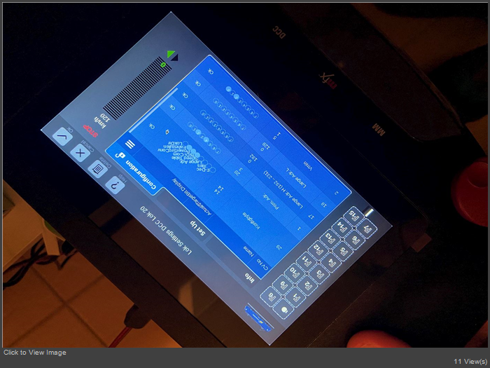

I think I might need more guidance, I was following your instructions and for some reason I am unable to fine CV 12 in the DCC mode. I looked up the manual for the Zimo decoders and sure enough, they also indicate CV 12 just as you said.
I have added some photos of exactly what I see on my CS3:
Am I doing something wrong? Perhaps I need to reset and start from the beginning.

For DCC use the CS3 load a limited set of CV's everytime, the most used ones.
To work with a CV that it is not preloaded, you must load it in the template.
For that click on the 3 lines at the upper right corner, a menu will appear, you will finf the "add CV" oprtion, if you click it a new CV will appear in the template, there you need to enter number 12, CS3 will read that CV and you will be able to modify it.
It is a good practice to save the modified template everytime you modify CV's so for later modification you only have to load it and not do the whole process of adding cv's everytime.
Hope it helps

Hi Francisco,
Thank you again so much, I have a lot more to learn about all this stuff… I am very thankful of people like you and Jean who take the time to explain things.
I just followed your instructions and it all works through the DCC!!
