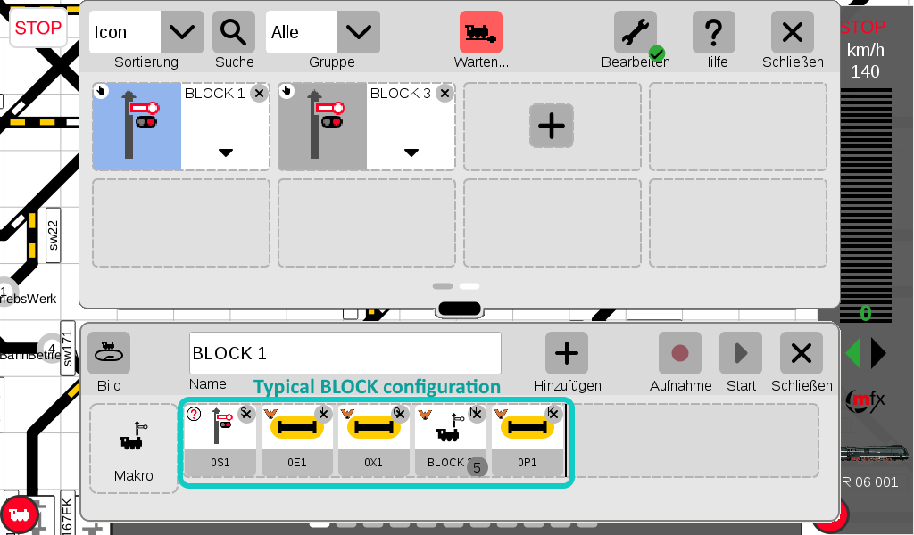

Since two Updates, the CS3 offers multiple MACROs namely ….
The BLOCK macro, like the other ones must be called by another event.
It contains 5 fields :
- The signal field Drag and drop the signal in this field
- The entry contact Drag and drop the entry contact
- The exit contact Drag and drop the exit contact
- The following BLOCK macro Drag and drop the following BLOCK macro
- The optional pause flag
When a BLOCK macro is invoked from another event, you get the following to fill
So I have filled 3 BLOCK macros (BLOCK 1, BLOCK 2 and BLOCK 3) the following way
BLOCK 2 follows BLOCK 1
BLOCK 3 follows BLOCK 2
BLOCK 1 follows BLOCK 3
Sensors are associated with each block
- 0E1 entry sensor for BLOCK 1, 0X1 exit sensor for BLOCK 1
- 0E2 entry sensor for BLOCK 2, 0X2 exit sensor for BLOCK 2
- 0E3 entry sensor for BLOCK 3, 0X1 exit sensor for BLOCK 3
- OP1 pause sensor for BLOCK 1,
- OP2 pause sensor for BLOCK 2,
- OP3 pause sensor for BLOCK 3.

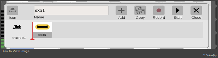

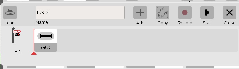

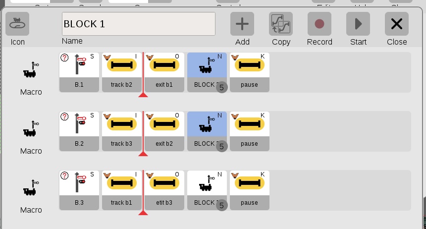

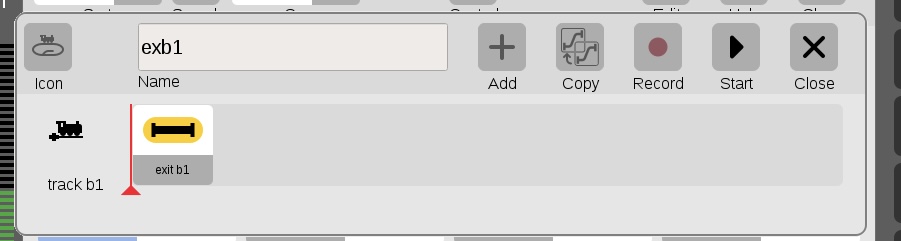

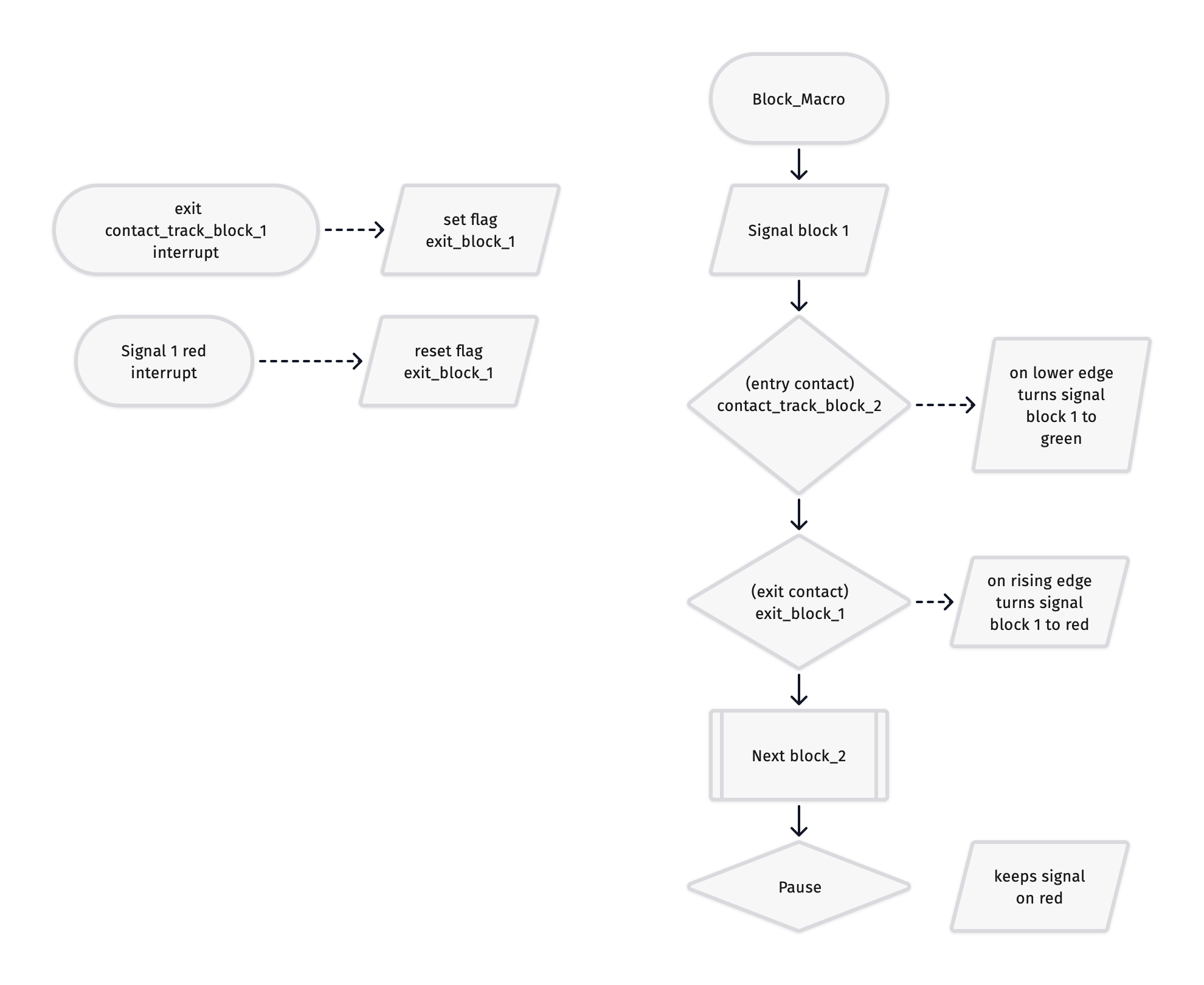

Hi I have tried cs3 block macro and I think I have figured out how they work.
The entry contact can be left clear
for the exit contact I used a flag that sets ones I leave the current block end resets ones signal turn red
While this block macro needs a short pulse to tell that your train has left the block I recommend using contact tracks as you need to now witch signal to turn to green when you start the system up.
And use a interrupts to create the pulse as I done in my example.
and I used pause to to stop the trains in first block
in my test I was able to run 2 train together without bumping into each other.
I’m going to try and add a station to the track and see how it works when I add a if macro to the block macro
