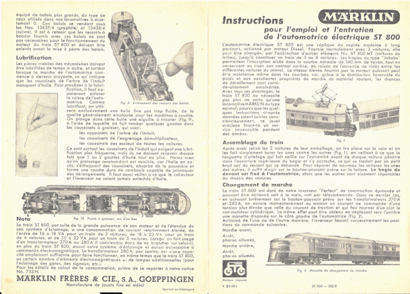

Hi Allen
Here is the French leaflet going with the ST800

As you know ST800, DL800, DT800 are part of the same lot of parts (like a Meccano) with many construction similarities

Download attached PDF for the ST 800 (1953 edition). Sorry I don't have the DL 800, only the DT 800. But if no one else posts the DL, I can get it easily. But they are very similar
ba-st800-y-1253.pdf (995kb) downloaded 64 time(s).
