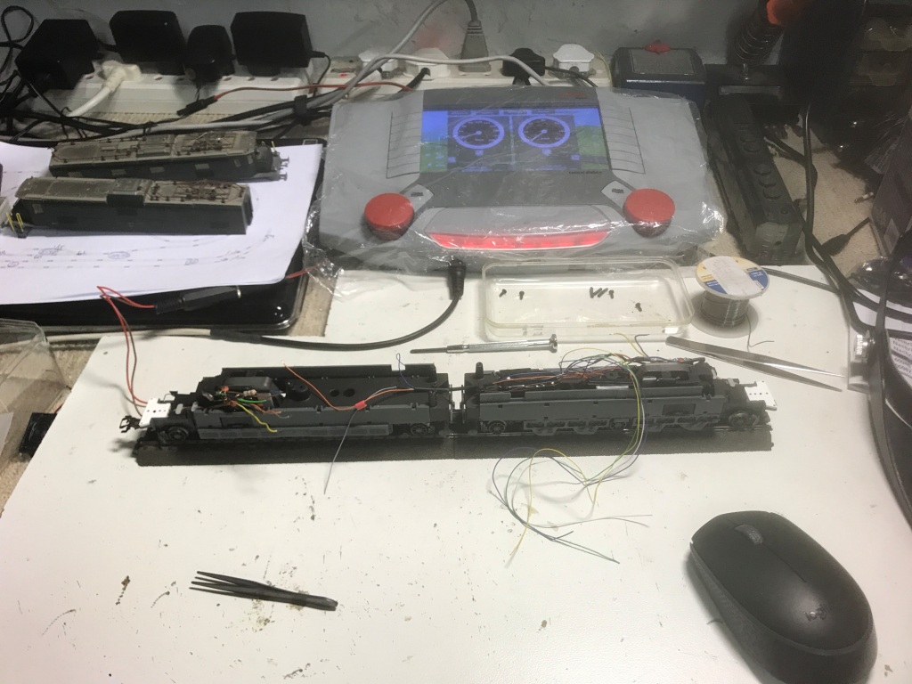

Hello everyone
With the positive comments received to my earlier question about whether a single decoder would work or not, I decided to go ahead and do the upgrade.
I am happy to feedback that it all works absolutely fine !
I used a Marklin MSD3 Sound Decoder 60987 and the motors run in synchronized fashion.
Swiss lighting achieved by using F1 and F2 to switch the left side light in front and back respectively, and F0 to switch the centre and right side light.
Remember to insert resistors and lower the power output from the lighting function outputs.
I also programmed slow dimming of the lighting when changing direction of travel to make it look more realistic.
Connecting all of the wiring :

John BigGrin

Nice conversion
Leave only the one capacitor between the two poles of the motor.
Cut all the others
Costas
