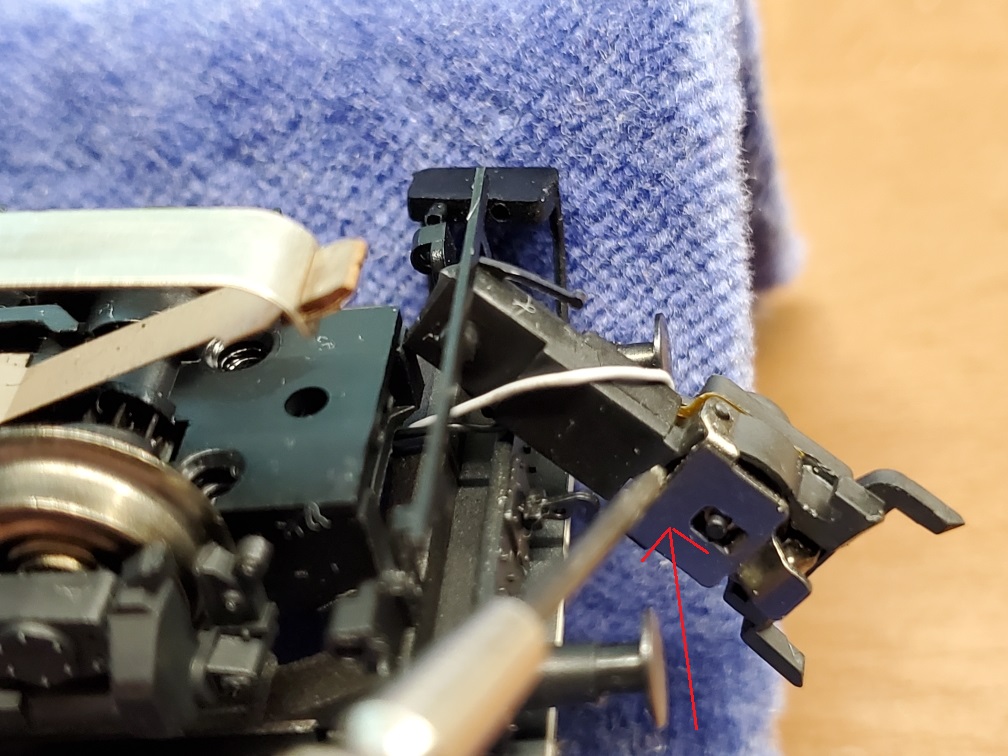

Here are some photos of the steps I took, I hope it will help someone else. It is a fairly easy fix.
There are 3 screws per bogie, two towards the front (outside of the Lok) and one towards the middle of the Lok.
(the arrow points to the place where the 2nd screw, in the front is, which is hidden by the slider in this picture.)
Remove the 2 screws towards the front, and only loosen the one towards the middle.
Here I have removed the NEM coupling pocket from the bogie, but the coupler is still in the NEM pocket. The pocket in this photo is still upside-down, in the red circle shows that the edge comes to a point, this should be facing upwards.
The arrows point to the holes from the two removed screws.
If you take a very fine screw driver and place it on the top side of the coupler, between the metal plate and the NEM pocket, give it a twist and the coupler should come out.
Flip the NEM pocket right side up (in the circle you can see that the edge on the bottom side of the NEM pocket is straight, compared to the 2nd photo were the top side of the NEM pocket, the edge comes to a point.) I hope this is clear.Huh
Return the NEM pocket right side up to the bogie ensuring that the pins on the NEM pocket line up with the holes in the bogie.
The red circle on the left shows the screw towards the middle of the Lok is still in place, just loose.
