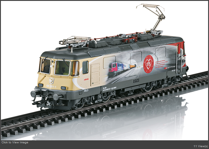

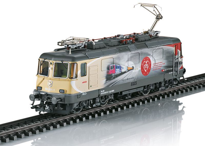

Hi All
My Club layout runs ZIMO on HO marklin M track. The system is Digital and uses the DCC system.
I would like to run my SBB 175 loco 37875 on the layout.
This Loco is marked as having DCC fonctionality in the manual.
Do I have to do anything to prepare for running on the club ZIMO layout and will I have any problem running my
loco on my own layout afterwards which is Marklin MFX.
Do you have any suggestions / recommendations ?
Tim

HI,
Your loco should run just fine on your club 'DCC' layout right out of the box.
However, you may wish to change the DCC address to something other than the default address '3' to avoid driving with other locos with default address 3.

Dear All
The test was a success, we changed the Loco number using the DCC system and all worked ok.
On returning home, the loco was recognised but the functionality was not OK.
I deleted the loco from my CS3 and reinstalled it, now it performs correctly.
