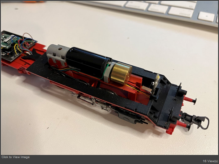

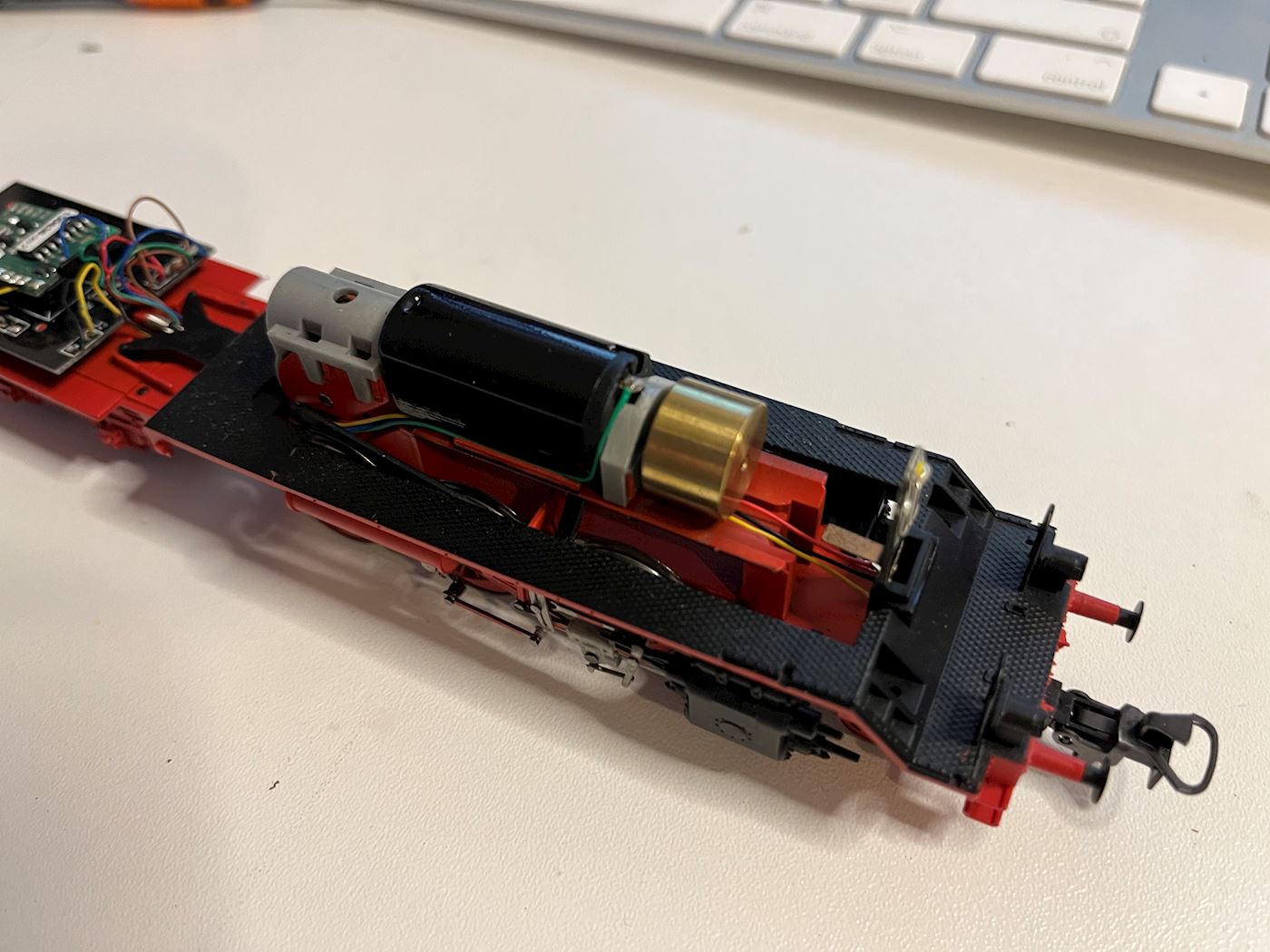

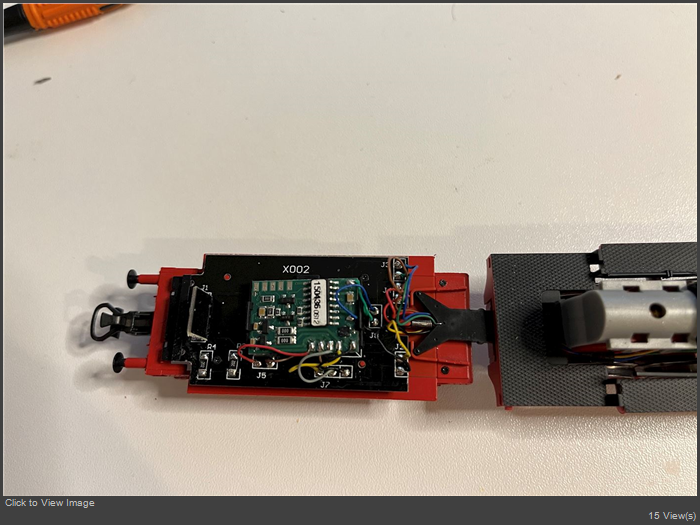

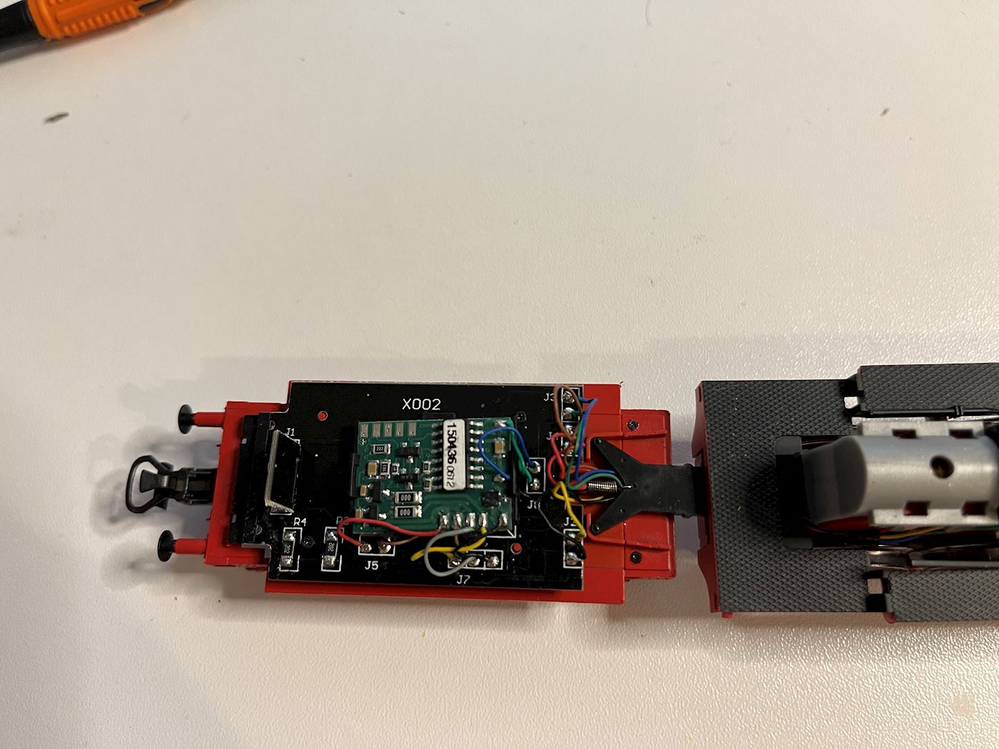

Hi! So a part of the mSD3 decoders are arriving today. So I opened up this BR24 for the first time to see the insides. Here are the photos below. So I'm no good at identifying motors (I'm just too new to the hobby). So is this just a regular DC or a bell armature?
Also now that I've been driving this a little, the FX decoder this loco has, seems to beat the hell out of the 60760 decoder I still have in three locos. Before I have the money to install mSD3 to every loco, I was thinking maybe I can use this decoder to replace one of them for now. Can anyone identify this decoder? It's not hard to track the wirings, and mutlimeter will help, but I assume these follow standard Märklin color codes. The loco I'm planning to transfer this has 60944 motor.
Here're the photos:
it is actually a variation of the 60760 decoder made for the br 24, ref: https://moba-hgh.de/modellbahn/umbauten/lokomotiven/maerklin-trix/maerklin-standard/168-modellbahn/umbauten/lokomotiven/maerklin-trix-hobby-lokomotiven/index.php?option=com_content&view=article&id=645:maerklin-decoder-familie-pic&catid=122:standard&Itemid=445#150436-36240-2
as for the motor, does it have any markings/numbers etc?

Ah ok. That is interesting... Maybe there are some minor differences. Driving characteristics were considerably better in my opinion...
No markings unfortunately. They must be on the underside. I'll keep searching for the info.
Thanks!
-Eino
