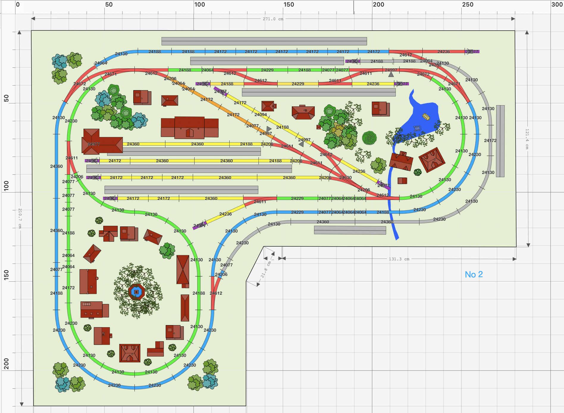

Offline Alex H
#13 Posted : 31 December 2022 21:04:54(UTC)
Alex H
Joined: 25/03/2017(UTC)
Posts: 125
Location: England, Devon
show us the progress in your layout drawings, please
This is a possible layout that I have come up with. Based on a template that I found online
Screenshot 2022-12-31 at 20.01.39.png (1,758kb) downloaded 78 time(s).
thanks 1 user liked this useful post by Alex H
Offline Copenhagen
#14 Posted : 01 January 2023 10:27:10(UTC)
Copenhagen
Joined: 23/04/2019(UTC)
Posts: 506
Location: Copenhagen, Denmark
Doesn't look too bad. But I don't get what the grey line is for. It branches out from the blue and abruptly ends after crossing over the red part.
Offline Alex H
#15 Posted : 01 January 2023 10:51:07(UTC)
Alex H
Posts: 125
At present I will probably extend the grey line around and join up with the inner (green) loop at the far end; then treat it as a branch line with a couple of small stations.
In the longer term, I might have an opportunity to extend the layout to the right, and so wanted to have a convenient way of getting ing the track over there without disturbing the main layout.
