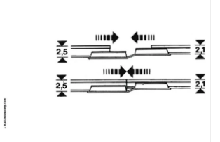

Mixing C track and M track (or K track) poses no real problem except for this one thing C track rail profiles (rail code) are much smaller than M or K track (code 100) and the only clean way to join rails is to use special joiners (Difficult to find but Fleischmann 6437 Profi track to 2.1 mm rail profile).
Another way is to bend them yourself so that the rolling surface is at the same level on code 100 side and code 80 side.
Filing the top of the rail does not provide a clean solution with smooth riding.
Additionally on the C track side you would have to do some surgery but no big deal
I hope this helps
Note that Märklin C track is 2.3 mm while M track is 2.5 mm.
With standard rail joiners there will be a height difference of 0.2 mm.
Using unmodified Fleischmann rail joiners there will be a height difference of 0.2 mm. No real improvement - unless you bend them a little bit.
Piko also offer rail joiners for the 2.1/2.5 mm transition: Art.-Nr. 55294.
