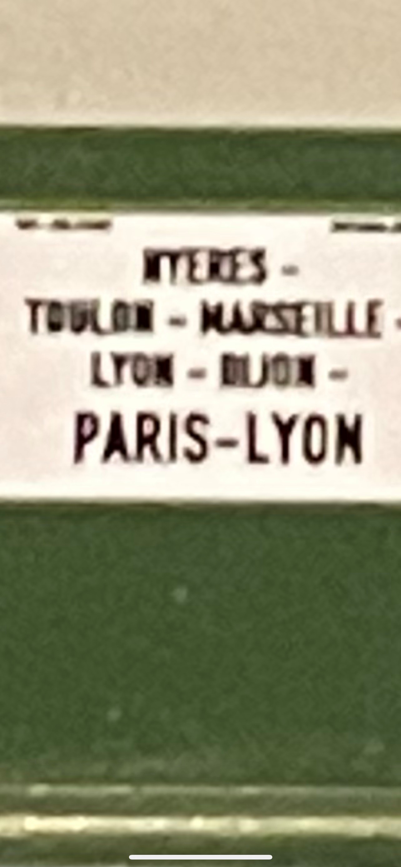

Your history lesson on the BB9200 and the locos is also well appreciated. I took a zoomed-in picture of the side of one of the 40691 coaches and then magnified it. The small little sign said: Hyeres - Toulon - Marseille - Lyon - Dijon - Paris-Lyon (I'm amazed at how well Marklin's printing/painting can do--can't read that with the naked eye).

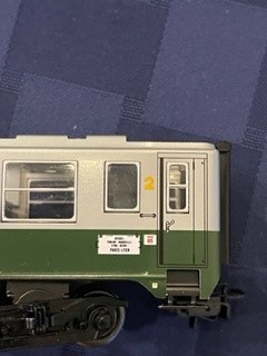

Marklin 40691 - Train Route Sign
"HYERES - TOULON - MARSEILLE - LYON - DIJON - PARIS-LYON"
[the last one I believe is the particular train station in Paris, PARIS-LYON]
Marklin 40691 - Train Route Sign Enlarged

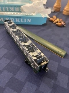

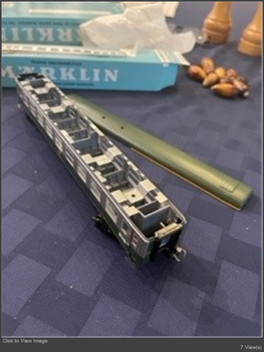

Marklin 40961 - Bogey, where light connection can be attached with a screw in slot underneath axle (remove one axle above slot)
Marklin 40961 - View with Roof Removed
