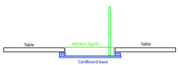

I had the exact same problem, trying to use old Märklin semaphore signals with a rather large mechanism.
My Solution was to cut a rectangular hole so that the whole signal and its mechanism could be lowered so that the top of the signal comes flush with the plywood top.
Height adjustemnt by using thick cardboard rectangles
Here is a simple sketch
Rectangular cut of plywood comes very easy with a vibrating tool / saw such as a Bosch one
