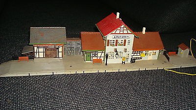

I'm trying to identify a Faller station kit catalogue number.
The platform has a number molded into the underneath, 1021149, and a search of the 'net shows a large number of sales using this number as the identifier, but this clearly isn't a kit catalogue number, but more likely the mold number for that piece.
I haven't taken a photo of mine (yet) but here are various photos from eBay etc ...
The basic station ...
As can be seen the station seems to be provided with various names, so I don't which is the original name it was given as a kit.
Mine has extensions to the platform like this photo ...
I presume these extensions came as a separate kit, and I would like to identify that kit number as well.

As to kit numbers, according to
https://www.altemodellbahnen.de/...ex-Spur-H.html#msg319544
Altenstein is B-102.2
Kirchbach is B-104.3
Talheim is B-105.2
The "Maienfeld" may have been modeller's license...
There may, of course, be others, and each kit may have had multiple nameplates, but I think these are the main catalog items. (at least as far I can find as of now)Cool

Thanks again for this link, which takes me to a page that has JPG copies of the relevant catalogue pages.
https://www.modelleisenbahnfan.d...ischenablage03-69-70.jpg
The Talheim model (B105) is the model without the extended platform and additional buildings, while Altenstein includes the additional parts.
Mine is missing the chimney on the main building, and some of the fencing. I'll have to hunt around to see if I can find some suitable parts.

If my eyes do not deceive me (and that is entirely possible LOL ) the wee Guterschuppen in the picture of Altenstein is B-156.2 "Kleiner Guterschuppen" and the one on the right is probably a random "Bahnbauten" (B-140.2?) and then they just added in the platform extensions (from a set of extensions and fillers, maybe?). "Kit-Bashing" at the corporate level LOL
Jimmy T
Dr Dirt's Rule #1 and
#8 Posted : 25 September 2022 13:44:07(UTC)
Posts: 8,650
yes, you are correct, it is mentioned on the guys home page.
The other kits that parts are drawn from ...
(images pulled from 'net)
The hut on the station platform is (I think) the middle one from this kit.
