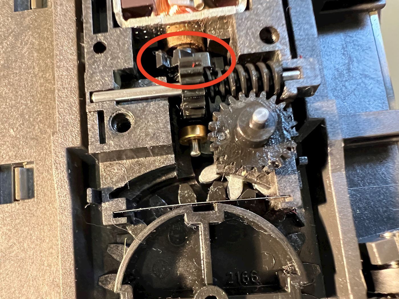

Just seeking some helpful advice from anyone that has a good mechanical background on the Marklin 7286 Turntable.
I am having a problem with my newly installed 7286 Turntable using a TT-Dec decoder operated with my Win digipet software via my CS3.
After spending a great deal of time getting the decoder and the turntable to work I finally had everything running correctly .
This was at least until yesterday. Now I noticed that the turntable is having a problem turning. Initially I thought It was a decoder problem but now have ruled this out by using my backup with no change in condition. I removed the turntable bridge and inspected the motor assembly and noticed the throw bar located was quite stiff and wasn’t travelling correctly.. On further inspection (once removing the 4 screws) I noticed the small leaf spring was disengage and out of position. I reseated the small metal spring back in position, reassemble everything thinking my problems were over. Well they just started!!! Upon reinstalling the turntable deck I would test the function and on the first test everything worked correctly. The bridge would turn to the correct spoke track but the second attempt to turn the bridge to a different spoke resulted in just a clicking sound with no movement. So, I removed the deck and rechecked and the small leaf spring disengage again. Put back and retested with exactly the same result. I must of tested at least 10 times and every time the throw bar gets stiff and the leaf spring has come out of its little socket. I have even tried a replacement motor assembly thinking there might some manufacturing defect, but I get exactly the same result. So I have to assume I am doing something wrong. So anyone who’s is a mechanical genius that can point me in the right direction with be of some great use.
Photo of the leaf spring disengagement and correct position attached.
Many thanks
Steve534502C0-47F3-45CB-AD20-11FE6485A897.jpeg8B183D82-993B-4226-A132-7C990D41D3B7.jpeg
Steve...............
Life with Pinot Noir, Chocolate and Marklin trains..........

HI Steve, I would have to tear mine apart but the part at the motor shaft doesn't look correctly seated from the angle of the picture. I could be wrong and it might not have anything to do with it, but again, it might.

Thanks Rick,
I did indeed check the motor seating. I think it must be a photo thing, but the motor is sitting flush in its compartment . I checked several times that every thing was in good order on reassembling. After replacing the spring back in position the throw bar will travel freely the way it supposed to be. It’s only during the second command ( as the first one works correctly) that the throw bar plays up. I’m thinking that the throw bar is pulling this spring out of its socket. But that only a guess.!

My guess is that the spring is coming out when the gear moves back the first time. When the gear moves forward into position the spring is already out of position and the unit doesn't work the second time. I guess it is possible that a small piece of the mount for the spring has broken off just enough to let it pop out. This may be difficult to fix if this is the case.

Hi Steve
Looking at your pictures, one thing is not correct
There is a rectangular spring that is not in its place.
Look here
It is supposed to be vertical and pushing against the main gearwheel
The other thing is the solenoid under the bridge does 2 things
- gets the motor started by closing a contact
- unlock the motor so that when the bridge reach its position, the motor is stopped instantly thus avoiding a "ballistic overrun" (bridge stopping too far.) The part circled in Rick's picture is the motor part to be locked when the spear (the long piece actuated by the solenoid) comes to rest.
Also, please don't be offended but your mechanism needs a good cleaning and only a very little lubrication.
Note: the 7286 Turntable is very silent and quite good but may become very bad when contacts are bent especially those at the end of the bridge.
Here is mine in operation. The noise you hear comes from a sound module
Sorry sorry for the things you know already. I hope you'l fix it fine.
