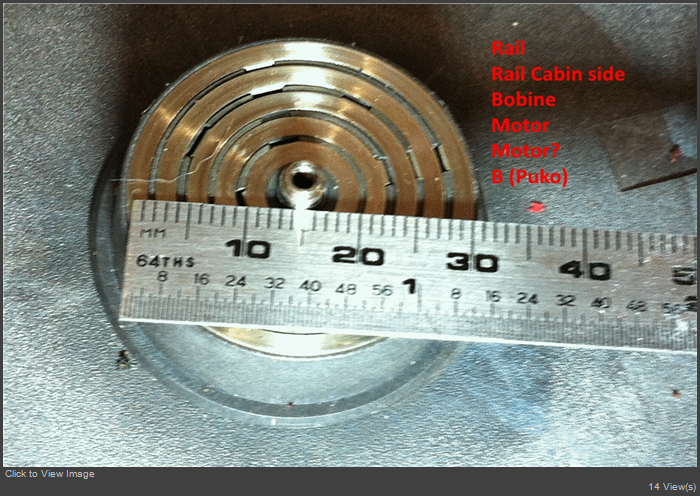

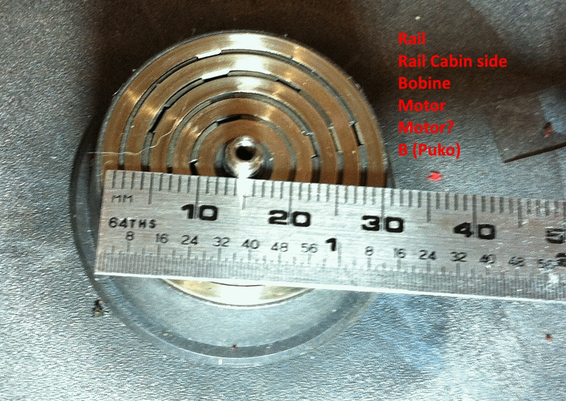

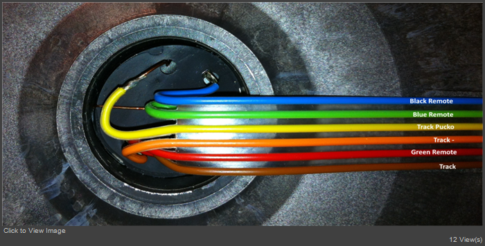

In the Fleischmann / Märklin 7286 turntable (with a multi-colour flat cable, the bridge track have 3 cables for connection
Here is the assignation of the contact rings on the TT
and the cable colour for the track are
- Brown one lateral rail
- Orange other lateral rail
- yellow: "center rail"
The other 3 cables are a link with the remote control
Since you are using the 7687 you may notice:
- B plug to connect the bridge's center rail
- O plug to connect the bridge's left rail
- O plug to connect the bridge's right rail
Here is a link to the 7687 users manual https://static.maerklin....876e4b34bc1574773383.pdf
I hope this helps
