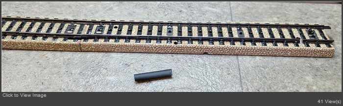

I have started to automate my M track layout with CS3+ and focused on use of contact tracks instead of (finnicky) toggle tracks. The latter sometimes get stuck and wagons with lighting sliders complicate the trigger. I have not tried reed switches on my layout.
I discovered after many crashes that the standard m track contact rail (5105 and 5104) has an isolated length that is less than the wheel distance of my modern trains (like ICE). Sometimes it senses occupancy, sometimes not. I can use a contact extension track and two 1/2 railroad crossing trigger tracks, but that is a lot of specialty track for one sensing segment (and hard to find, and expensive).
Is there a clever way to make one's own contact segments with M rail? I experimented with cutting rail, but it remains grounded to the metal base regardless.
Some cutting and soldering is fine. Thoughts, Marklin peeps?

I have made a couple dozen contact tracks using the method reported on Stummiforum with a couple of modifications. This approach has the benefit that I now have also parallel radius contact tracks (5200) which Märklin never offered.
However, the length of the isolated part of the track still remains short, so the issue you note is still in place. In my case, this does not matter because Rocrail works correctly even with very short isolated sections.
I have noted that keeping the wheels of the cars clean helps in registering the occupancy.
I think I wrote a short piece on this topic on this forum, but I cannot locate it any longer. My comments on Stummiforum mention the changes I adopted.

Went straight to the shop to try this.
Wow, shrink tube for isolation works great; see pics. I can make the sensing track any length with this method. I just added marklin stock interrupt for testing, but will modify 2 straights to make my own.
Great solution, Martti!

Hi Martti
Thanks a lot for this information. I find this trick simply genial.
On the other hand, I suppose you can do this on a complete rail section (without cutting the rail). This will allow you to have a long detection section just like with C or K track.
The rest of the trick is unchanged. Simply 1 recommend to install a narrow adhésive tape under the joiner to avoid accidental contact with the metal ballast.
Also in this case the ballst drilling and wire soldering may be skipped on all rails except one
I must confess I have not tried it (I use C track) but I really believe this is easy to make.

Thx for the alternative suggestion of using current instead if mass sensing. However, I believe this requires s88 DC modules, whereas i have l88+s88 ac modules on my M track layout.
Making my own contact tracks has solved the length limit. Connecting two homemade contact tracks does take soldering of a feedback wire and cutting a small space below one connector to avoid metal base contact (just like stock m contact tracks have).
