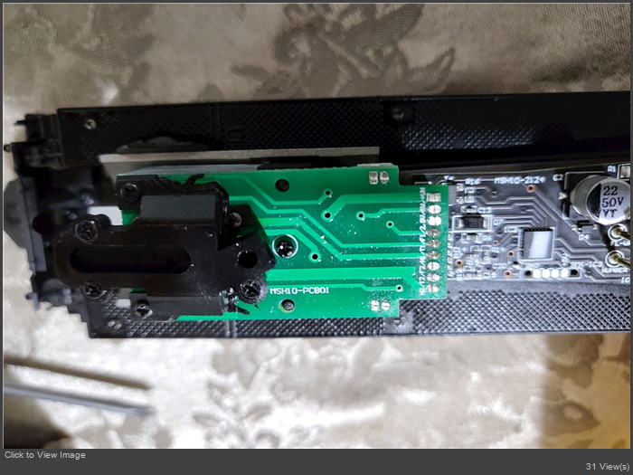

Here is the Smoke unit. I can't smell anything like a burnt out circit board
There is a black residue around the unit but it could be an apoxy or a seal.
Hopefully nothing major
#4 Posted : 16 April 2022 11:37:13(UTC)
Posts: 9,300
I cannot see problem from here.
I see the black screw seems not fitted all the way down?
It could be fault with the decoder.
Warranty to fix the problem?

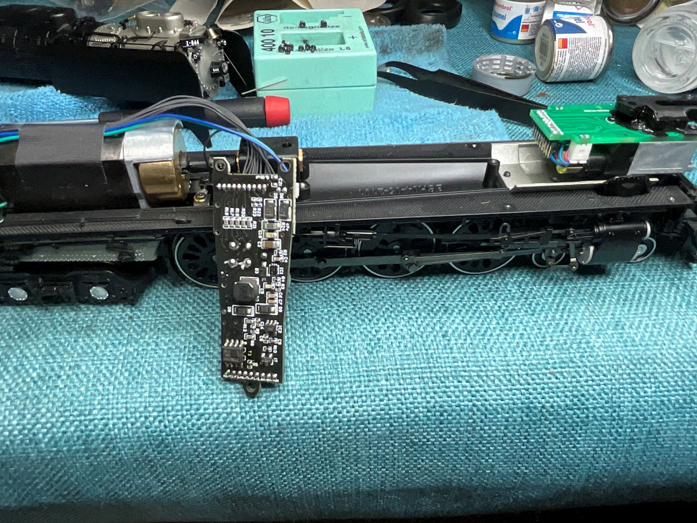

A friend of mine had the same problem with his UP 844, I decided to inspect the locomotive and found a problem in the control board that is connected to the smoke unit in its backward.
It is clear in the photo that there is a burned component.
This loco will need to travel to Marklin service since that board is not available in the spare part drawing.
Doe’s anybody know if that board is available?
Eduardo

I discovered that Märklin on this loco used a different (early?) model of dynamic smoke with a much higher current.
I don't have this 37984 loco but users report a power drain of 2 Amp when smoke is on. This is to compare with the newer BR06 (39662) with a current drain of 550 mA.
Why on earth would Märklin allow to draw 2/3 of the available current on a CS3? Buts apparently it does! Weird.
For sure Märklin is now using this newer type of dynamic smoke unit (E335382) which is different in form from the E353931 in your loco 37984.
Yes dynamic smoke model have an auto-shut off after 3 minutes and - at leat on my 39662) - it is OK to turn it on rapidely after it turned off provided there is smoke liquid in it.
Yes usually Märklin does not ship the PCBs but rather keep them for repairs in their shop.
Maybe, talking to them, if you live overseas, they may make an exception and give you the part number to order.
Maybe there are some design issues that need corrections (happens sometimes) to be done only by the trained technical service (I use the one in Göppingen)

Here is what I think is happening. I don’t think it is a thermal cutout, I believe smoke oil is getting on to the circuit board directly behind the smoke unit. This is causing a short and a high current draw, noise through the speakers and an overload of the CS3.
I thought the burning smell was from the tender, but I think it is from the front of the loco now everything has cooled.
Smoke oil will evaporate in air eventually, even without a heat source. So I think the loco works again when the oil evaporates enough from the circuit board. So…..
I am going to take the loco body off, spray the circuit board with contact cleaner and then wrap the board in Klapton tape (heat resistant clear yellow tape) the aim being to prevent smoke oil residue from shorting the board in future. I will report back in a couple of days, once I receive the Klapton tape. I just hope no permanent damage has been done, but I have most of the 2 year warranty remaining.

What smoke oil have you used ? eg did you use the recommended Marklin 02421?. Or did you use the 02420 or a different brand etc?
and did you at any time accidentally overfill it?
Offline AshleyH
#28 Posted : 22 March 2023 09:55:23(UTC)
AshleyH
Joined: 15/02/2008(UTC)
Posts: 693
Location: Bournemouth, Dorset
I used LGB smoke and track cleaning fluid.
Hence, my guess about it being conductive, as it’s dual purpose for track cleaning.
I have my clear Klapton tape, but I haven’t yet taken the 844 apart to try it out.
Perhaps the recommended smoke oil is non-conductive, so it won’t create a short if it gets on to a circuit board.
We have a new puppy, which has somewhat delayed my train experiments 🤣
