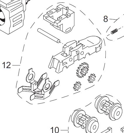

Does anyone here have one of the BR212 models, 88216, 88690, 88691, 88695, 88699 etc?
I was slightly tempted by one that came up on eBay recently, but by the time I decided I was really tempted it had gone! What intrigued me was to see that it has reduction gearing in the bogies, which I would normally equate to good slow speed running. If anyone has one I'd be really interested to hear your assessment of its running characteristics.

I do not notice gear reduction on this model. It will pull a few wagons on my hill layout. I know three, four axle passenger wagons is no problem, but a forth will be a struggle. The wheels will just spin but I will do it. The 88690 was the first model released and it came with the five pole motor, it is fast and not very noisy. The new bell motor is even more quiet but does not seem to add weight. It seems to lack the weight or gear reduction needed to be a top puller, but on my layout it will pull five to seven 2 axle wagons. I watched a YouTube recently and on a flat layout, it will pulled many more wagons than I expected. I am not certain how it will perform on your hills.
The frame and upper shell are all metal and it has a good feel in your hand, unfortunately this does not translate into spectacular hill or pulling performance. The upper shell just pulls off easily for cleaning. It seems to be firmly held on by the springy contacts for the LED light. The unusual aspect of this model is that the circuit board is not one piece and does not run the entire length of the frame. Over the motor there are two copper circuit bands which connect the two small boards on each end.

Hello Chris. Hope all is well.
All good here, thanks - hope everything is good with you, too
By this I refer to the gearing in the bogie
In the exploded drawing you can see the compound gear which will reduce the gearing in the bogie. (Probably not the right terminology, but hopefully you get the drift!)
Of course this won't help the traction, but it will reduce the speed. My theory has it that locos perform better if the first reduction gearing is the worm (which is quite a large reduction factor). Most (3 and 5 pole) Marklin diesels have a spur gear reduction between the motor and the drive shaft to the worm. My theory has it that, because this is a fairly modest reduction factor the load on the motor is still quite high and so slow speed running is not so good.
Isn't Z gauge fantastic for making amateur scientists of us all?!
Have a great weekend
Chris

Hi. Oh, okay, it obviously has gear reduction.
I have an E44 which has gear reduction which keeps this locomotive from being fast. I think of this one as a good puller.
The 212 is more similar to the newer 216/218 models. Perhaps.
Thanks.
Dwight
I'd heard the E44 was quite a formidable little loco. It would actually suit my layout quite well, but it has no catenary which has put me off so far.
You're quite right that the coreless motored BR216/218s don't have reduction gearing between the motor and worm but I don't think there's reduction gearing in the bogies, unfortunately. I've taken my 88807 apart enough times, in attempt to get it to run more smoothly, I'm sure I would have noticed!
