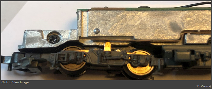

A95A9DC4-3DEE-462A-9916-4F2CE2103A27.jpegFA6C9ABB-DC54-4DB0-9AAB-56300727E268.jpeg402C7DF2-9A51-4909-8968-01700EA3B309.jpeg
Well, the full test of the 88234 Vectron on my larger Noch layout began this afternoon:
It didn’t get far - it hadn’t been going for more than a few seconds when 3 of the four pantographs popped up and refused to stay down. The inner circuit includes a dive under with insufficient headroom for raised pantograph.
Next, on moving over to the inner-circuit, which is mostly 190mm radius curves but has two 145mm ones, it derailed on the first 145 one it encountered, and derailed every time with either end leading thereafter.
Because the Noch has inclines the track cannot be level and this loco, along with the V80, just cannot cope with 145mm and slight irregularities. With one other exception every one of the 150 plus Z locos I own can cope with both Noch layouts’ curves and inclines. If their products can’t cope with 145mm they should say so - it is their fault for changing the design of bogie/truck mounting and pickup arrangement without -it would seem- thoroughly testing it.
My one Rokuhan Geman outline loco copes with anything.
So, the Märklin Z Vectron is pathetic for those of us who do not have the luxury of all-wide radius curves for our layouts, and again, why did they need to redesign the trucks when the 1973 variety worked so well?
If I contacted the firm would they be interested? I doubt it.
Disgusted of Guildford
aka ChrisG 😒
thanks 3 users liked this useful post by Mman

Commenting specifically on the pics of your chassis, the trucks are obviously special for this loco but the method of power pick up is very familiar to me from my AZL locos. Beware if those long strips wedged into the frame ever come out (get loose). It can be a real chore to get them straight and secure in the frame again. Moving on I can think of two points where drag could restrict the truck rotation. One is those wipers, on your chassis the long strips could be binding against the underside of the metal chassis and creating a lot of pressure pushing down on the wiper on the truck. I am used to seeing the long strip pushed up by the wiper but bending along its entire length (after the mid section where it is wedged into the chassis) here it is bending up only about half its length, so the load is greater. That might be hard to change. The other is the method that those trucks "snap" into the chassis. In theory they can be pulled or pushed in or out of the chassis without damage but I always loosen the screws connecting the frame halves a bit before I do this. If the loco was mine I might try slightly loosening the screws to see iff the trucks would loosen up, also I would pull the trucks out and inspect them looking for any plastic flashing, imperfections, etc. that might be causing binding. I would reassemble them with a bit of that white grease they use (or Molykote from my supplies) for the gears on the bearing surface.
