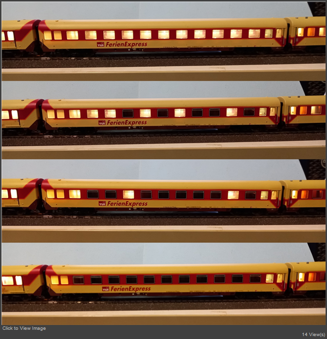

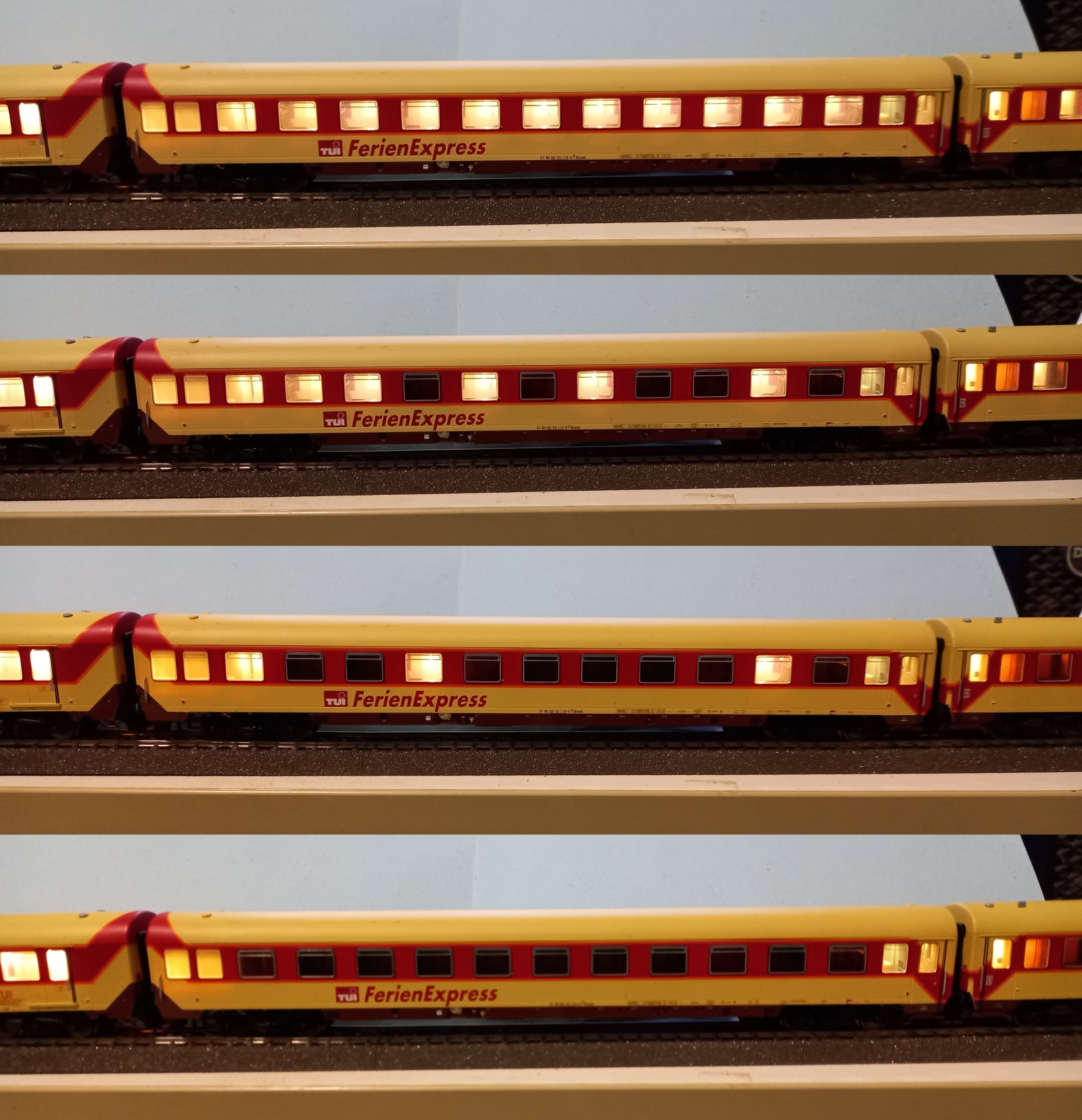

I went one coach-one light route, so only needed to install LED strip (with intensity regulator), parallel capacitor and shoe (metal coaches offer ready ground or wheel insert for plastic coaches). Cost is ~$13/coach (excl shipping).
Ben van der Pluijm--

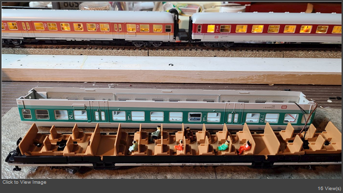

It is noticeable to me that many lighting kits do not light the entry/gangway vestibules. I would also like to see a system where you could have switchable lighting for compartments but dimmer but constant lighting for the corridors and washrooms.
Something like this ?

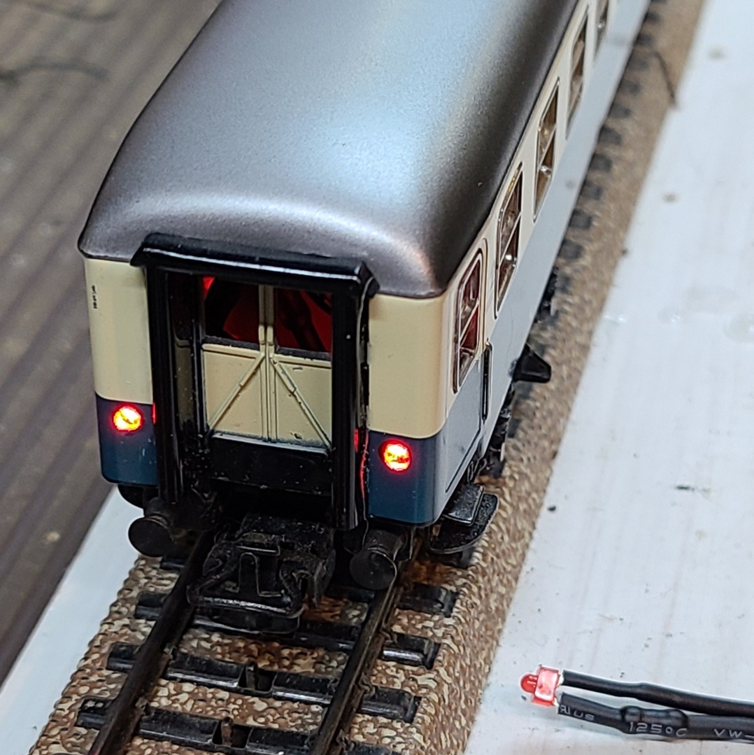

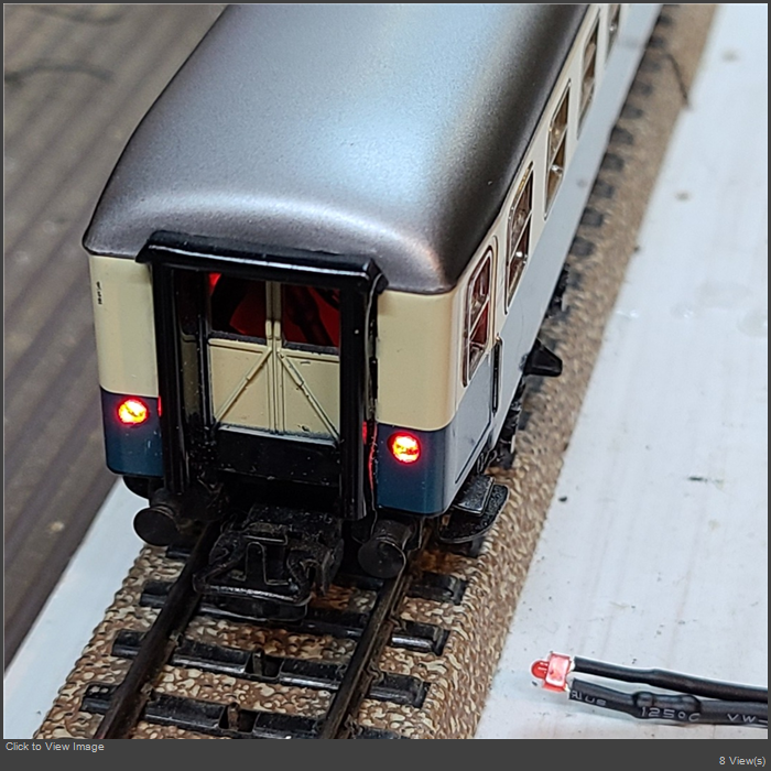

My effort evolved. I installed conducting couplers to connect power from one shoe to all cars. The advantage of plastic cars is absence of ground, except at metal wheels. Just make sure to use a seperate feed for couplers and not tap rectified power from the LED strip.

After learning to add led strips and conducting couplers for interior lighting, l decided to tackle tail lights.
I found small tower leds in red. Drilled 2mm holes in carriage that fits narrow top of led. The location of holes is usually marked by fake, painted lights.
I replaced the wires with thinner, more flexible wire, and soldered to rectified power of the led strip.
The tail lights are 12V, so 5V from strip reduces brightness just enough. Note that I opted for smaller leds than more common 3mm tubes, as those make lights too big.
The pin leds are individually glued in drilled holes and the result is great.
thanks 6 users liked this useful post by BenP
Mario, looks great!
How do you control the varied change? If you use a decoder, as I would guess, can you tell us how much work or how many functions you set?
Offline mario54i
#32 Posted : 12 June 2022 12:42:13(UTC)
mario54i
Joined: 28/03/2007(UTC)
Posts: 308
Location: Torino,
Mario, looks great!
Thanks Mark
It's DIY.
Basically a function decoder with (up to) 29 independent LED outputs plus 3 amplified outputs for corridor and tail lights, in the shape of a light strip.
Software takes care of deciding which light is on or off, some are always on (e.g. restrooms), each coach behaves independently.
