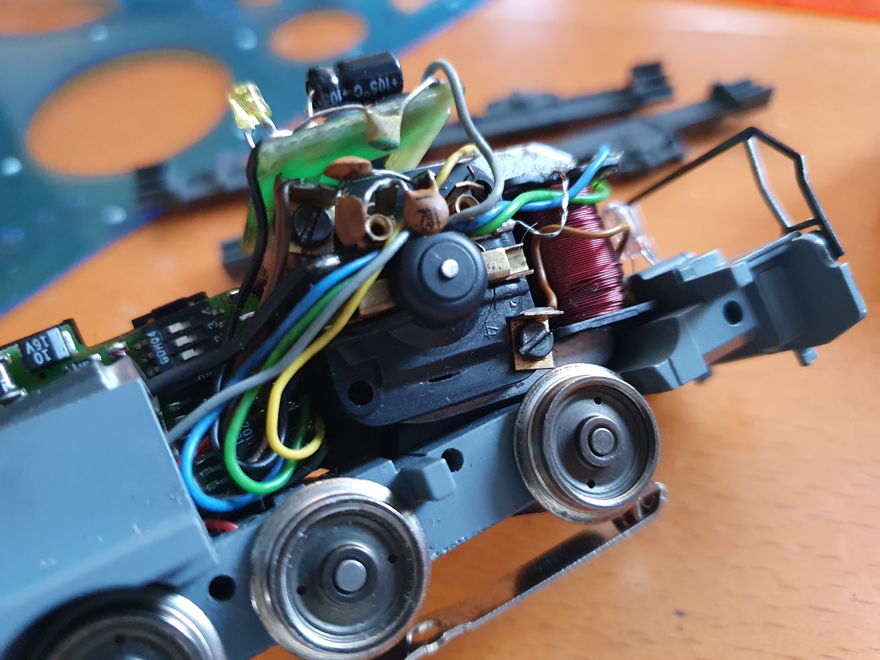

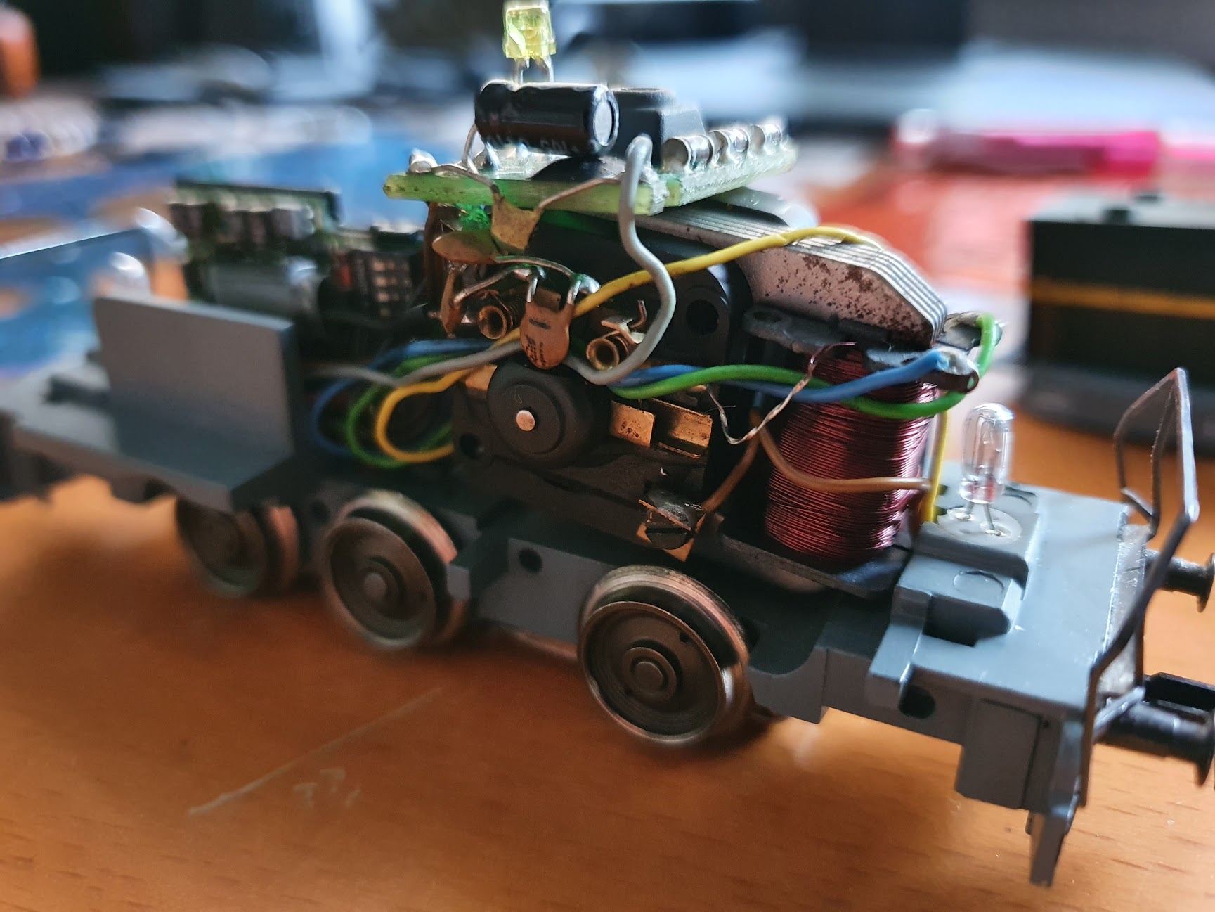

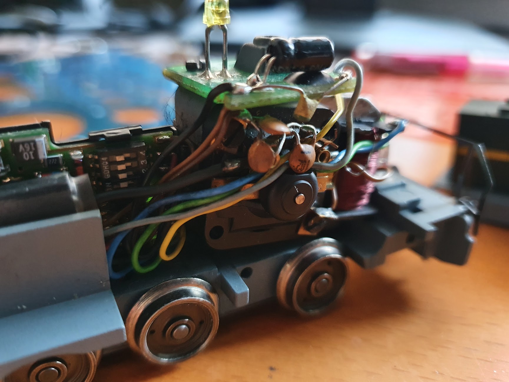

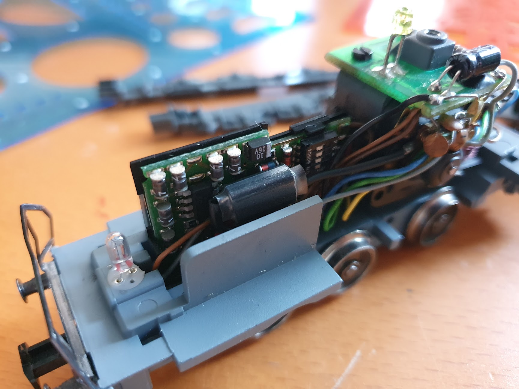

Hi! I have never converted a loco to digital before, or done any sort of modification on any of my trains, I would however, like to start somewhere. The first set I ever bought was the 29146 starterset. It included a little green Henschel locomotive with a Delta decoder.
Now, I would like to convert this loco into full digital with a new smoother 5 pole motor and maybe some LED lights. Like I said, this will be the first train I ever conduct any sort of modification on, but I figured it's a good place to start.
For my questions, I would like to use as much Märklin parts as possible and I don't think I'll be aiming for the installation of a speaker or any sound features as of now. What parts should I go for? Is there a full "conversion kit" I can buy? If not then what decoder should I use, and what motor? Is there anything else I need? Any general tips for a newbie in this field will be greatly appreciated. I have included some pictures of the inside if they are of any help! Thank you in advance!

Hi Crocodile (Funny first name)
You may start with one of those solutions
- one cheaper is to use the 60760 kit (includes a 5 pole motor and a decoder). You end up with a 5 pole motor loco with a MM2 decoder (not MFX)
- another is to use a 60906 decoder allowing to keep the existing motor and also have MFX. Note: the motor will not be regulated
- one, more expensive is to replace the motor with a 60941 one and install a 60982 MFX decoder.
To replace laps with LEDs is more tricky and don't forget to install a resistor in series (1 kOhms to 2.2 kOhms)

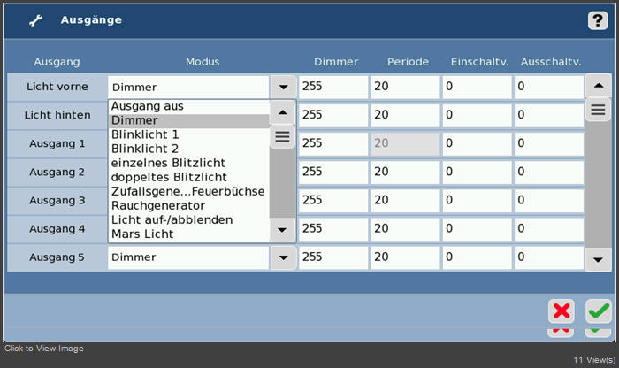

I would recommend option 3 as I don't think you will be able to get the LED on top to flash with either of the other options, it will be off or on according to the function you use. It should be possible to configure the 60982 decoder to make it flash - but this will most likely require some help from someone else with a Marklin programmer of central station 2 or 3 to set this up.
No, all options are OK because (1) any output of Märklin decoders may be set to blinking (Mars light, Smoker, Telex, etc) and (2) because the small LED circuit includes all what is needed to drive the LED warning light from any AUX output (Depends on the wiring). Here is an example of programming an output using a CS2
Same is possible on the CS3 but I don't have the image
