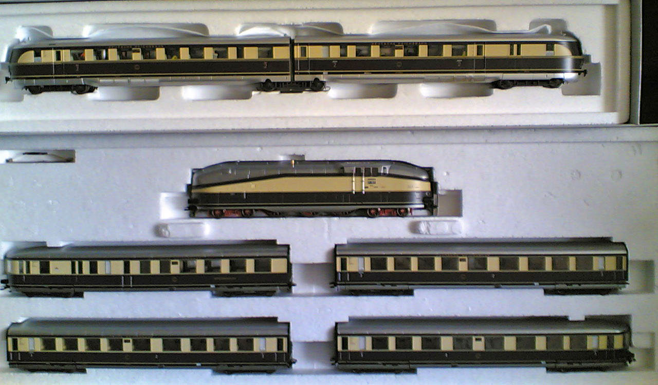

Has anyone installed lighting in the Marklin 26610 passenger cars? If so how did you remove the tops to access the insides?

The 73150 manual is a typical lighting installation manual and won't solve how to open the end cars, it isn't documented in the 26610 manual either. The buffers on the end cars have to be removed.
For those interested I have installed lighting in this train set, please read my article below.
26610 LED Lighting
Link corrected 31-12-2024

First, the cars open very easily by removing the rubber intercirculation pieces at each extremity of the cars. At each train extremity, you must remove the 2 buffer on each side.
WARNING: those cars are extremely fragile. The bogie skirts rotate mechanism is very very delicate.
When the set was produced Märklin advised to use the lighting sets with bulbs and light conduit. In fact it is not exactly made for those (bending the body slightly) and I ended up installing self adhesive LED bars (12 VDC 5 m long on the internet) coupled with tiny light regulators modules on each car and current conducting couplers.
Here is my Henschel-Wegmann train with the BR 61 controlled by Rocrail

I looked more closely at one of the middle cars and discovered that the door outlines at each end were not, as I thought, decorative, but could be removed and that allowed the entire roof to be removed. That may allow me to install lighting without removing the interior which it is difficult to replace. Will try that next.
