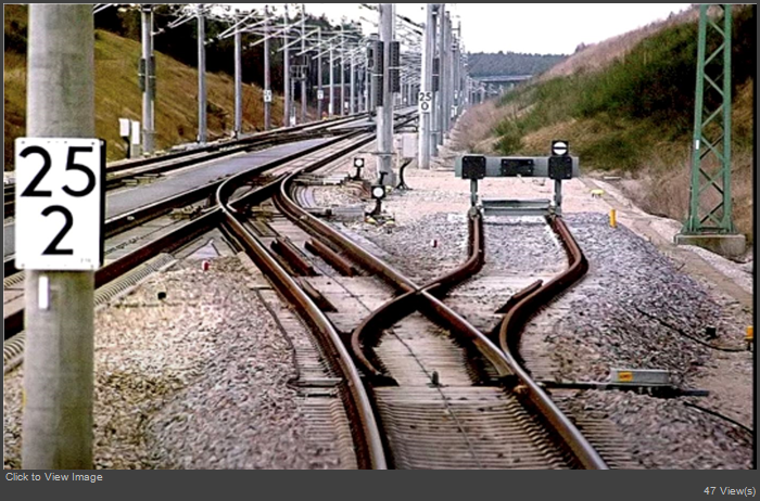

I was looking at some railroad pictures and saw this, any idea what such a short track is for?

It is hard to tell the length of that track because of the photographic zoom perspective. However, it appears long enough to hold a wagon or a locomotive. Perhaps a MoW car, a shunting locomotive, or something similar that needs a short term storage spot to allow traffic to carry on.

It's a "catch point", also called "trap point" Cool
Explanation on Wikipedia, where also the picture you found appears BigGrin
https://en.wikipedia.org/wiki/Catch_points

Using such a "catch point" to stop a train from entering the main line would likely still impact on the main line and any traffic on it at the time of the incident.
I would have expected that a catch point would be designed to guide runaway traffic away from the main line to make any derailment as safe as possible.
As the trackage looks like a HSL (High Speed Line), I was wondering whether this spur was designed with the tunnel rescue trains in mind, so that the lead locomotive of the rescue train could be removed, enabling the fire-fighting or rescue section of the train to take the lead.
Looking at the Allersberg Station on Google Maps: https://www.google.com/maps/place/90584+Allersberg,+Germany/@49.2275976,11.2201103,1923a,35y,90h/data=!3m1!1e3!4m5!3m4!1s0x479f420c60bdea29:0x41eda32beb606d0!8m2!3d49.2513132!4d11.2365846
The station is on the HSL and expands from two to four tracks. At each end of the Station Tracks, there is one of these short sidings. It is possible that they are there to to keep trains from rolling on to the mainline. The location is also just before the Göggelsbuch tunnel, so it may be related to the rescue train operation as well.

The photo is from Wikipedia. Other pic's show derailments caused by these.
The video in this link shows why you have catch points ... Scared Crying

This arrangement is called a Schutzweiche. (Direct translation: Protective turnout)
The turnout is locked to the exit signal. If the signal is red then the turnout is set to the short track. This prevents a train on the siding from running into the mainline if it starts against a red signal. The PZB system in the stopped train will prevent the speed from exceeding 25km/h and the 500Hz Indusi will also apply emergency brakes, but those alone might not prevent the train from fouling the mainline, so the Schutzweiche keeps it off the mainline.
Sometime the track after the Schutzweiche is also set lower on the side away from the mainline to the errant train will fall over, away from the mainline. When between tracks being protected it can also drop into an arrester bed.
Model of modern station siding should include these but they come at the cost of an additional turnout and a bit of track.

The same photo of this modern overrun protection had already been disclosed and discussed earlier in 2018:
Well, there is a modern example in Allersberg (Rothsee) where the stub track is parallel to the mainline track.
A "vintage" version:
The caption under the photograph reads: "Schutzweiche mit kurzem Schienenstrang und Gleisabschluss. Weil der Schutzstrang auch zum Abstellen von Fahrzeugen genutzt werden kann, ist er mit einer Gleissperre versehen. So soll verhindert werden, dass Fahrzeuge auf die Schutzweiche zurollen können."
Own translation: "Catch points with short stub track. Because the protective stub can also be used as temporary storage for vehicles, it is equipped with a track lock. This is to prevent vehicles from being able to roll onto the catch points."
http://www.dybas.de/dyba...ndex/s/schutzweiche.html (dybas = "dynamisches Bahnarchiv" or dynamic railway archive)

This is a safety device aimed at not letting a run-away wagon riding into the main line. This is particularly needed if there is a slope down to the main line.
Here in France you have this on all industrial branch line.
Alternately, you may have a de-railer (a device forcing the wagon to roll on ballast and ties and stop rapidly.
Here is the Peco version of the derailer (derail switch)
