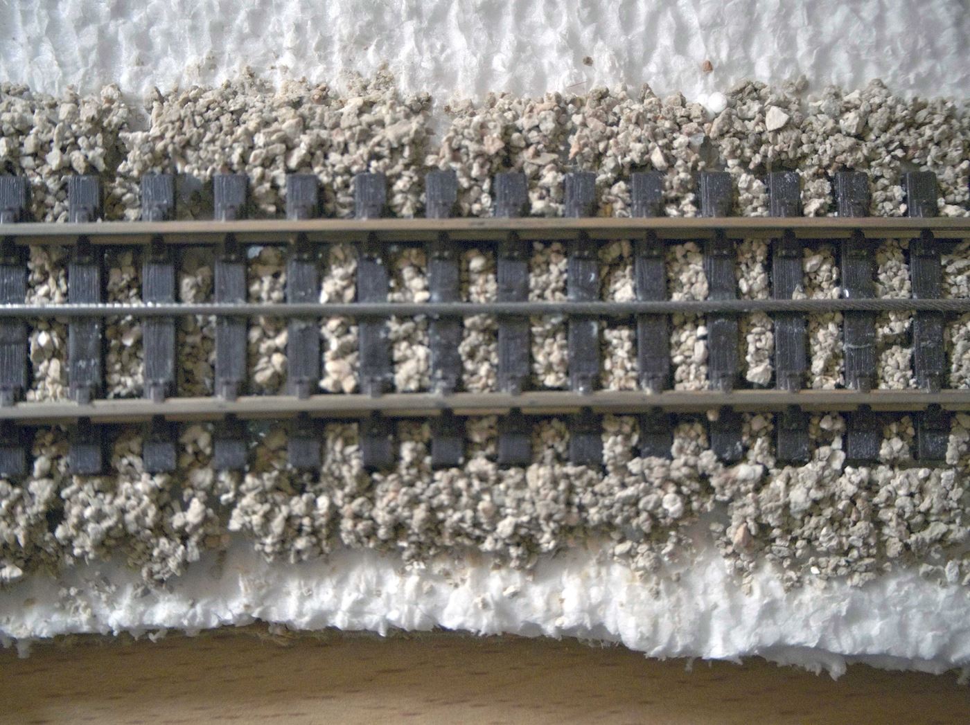

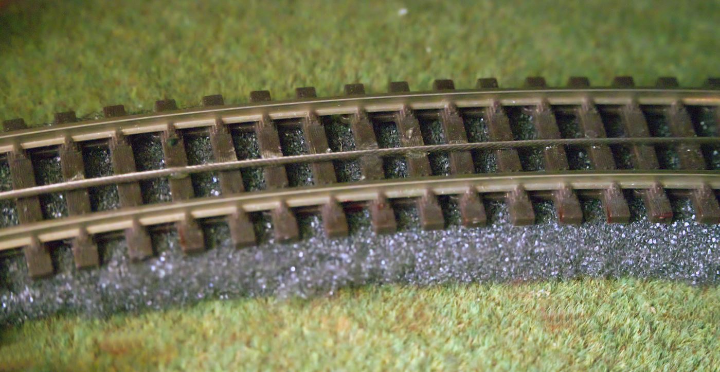

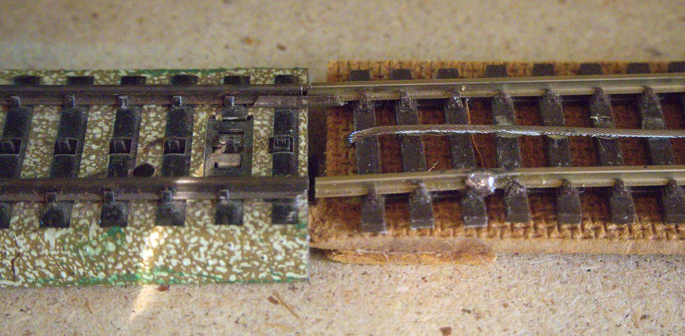

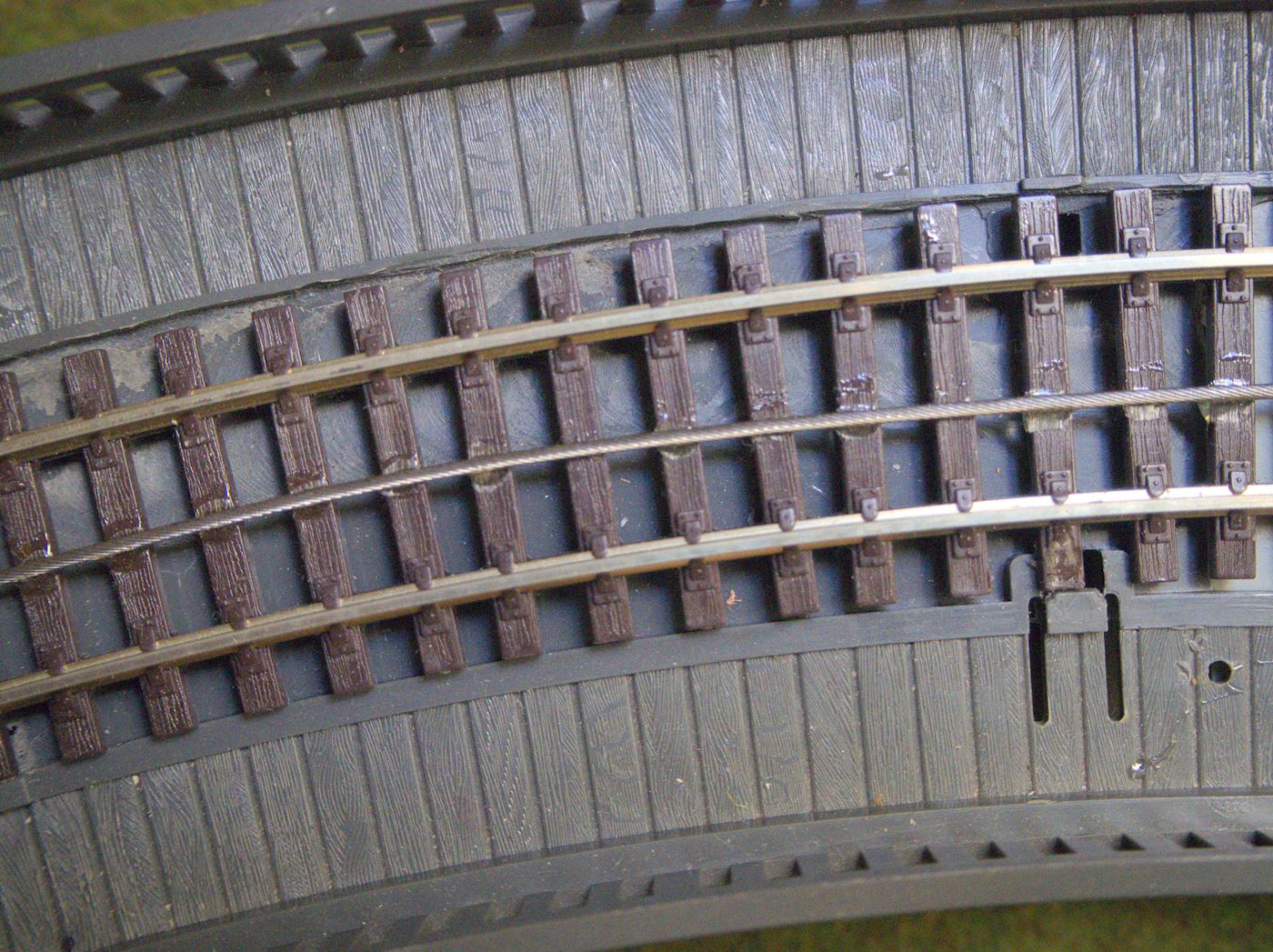

In order to use Peco flexible track last year, to combine with C and M Märklin track, the dedicated pukos were not available, and they are suitable only for a hard trackbed. I found an easy and cheap solution, by sticking in the middle a steel cable for gear change in bicycles (1,1 mm diameter) with very small drops of Araldite using a toothpick. The following pictures, though of poor quality, provide a good idea of the look on foam, on a bridge and with ballast, as well as the transitions with the Märklin track.Via Peco en foam PB240214.jpgVia flexible en puente PB240208.jpgVia flexible a M PB240209.jpgVia Peco en balasto PB240215.jpg
Edited by user 25 November 2021 12:12:37(UTC)  | Reason: ordering picture and mispelling
