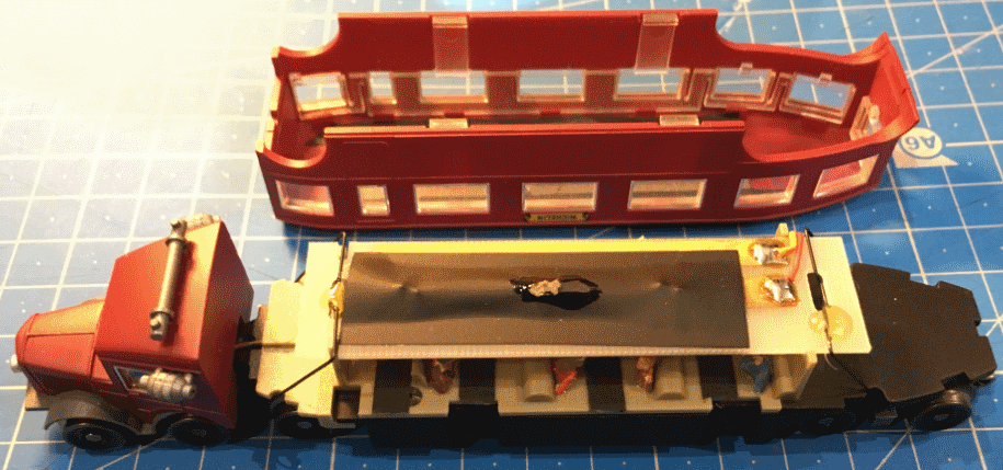

Here is the open body of my 3624 when I installed an MFX decoder with LED lighting and front light
Here is the result of the change
I love this car but it is very light and sensitive to current picking issues

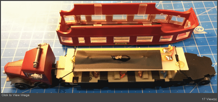

Michelin Bus LokPilot Upgrade
See pages 2-3 showing problems with the collector shoe.
Adding Front and Rear LED Lights to the Michelin Bus
Links corrected 31-12-2024
Nice front and rear LED light upgrade for those that want to go down that path.
Hope the info. is helpful.
