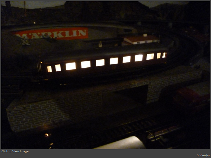

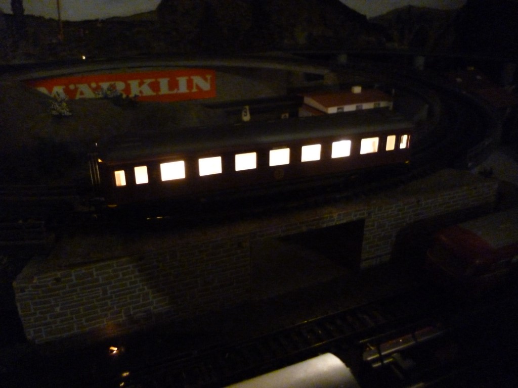

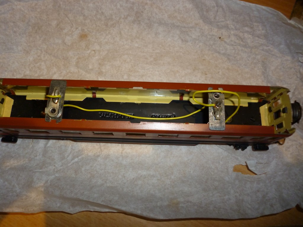

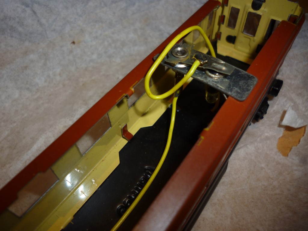

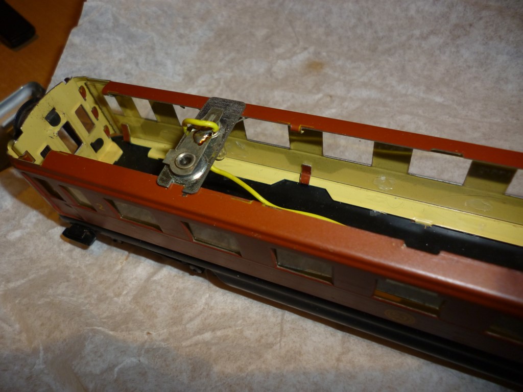

#4 Posted : 30 June 2021 12:20:21(UTC)
Posts: 4,013
Originally Posted by: pederbc Go to Quoted Post
Thanks Nigel,
Yes, I want the ”original” type of lamps if I can find them. Now on to eBay etc…….
Best regards, Peder
Hi Peder,
One of my favourite coaches, I have the 3118 set plus an extra 4020, makes a nice consist. Mine are all lighted so I thought you might like to see the installation?
Two images showing the lighting, the better one is with the flash, the other without, sorry camera is not the best. The interior colour helps spread the lighting well so you don't get obvious bright spots at each end.
Adding interiors would of course give an additional dimension but those are harder to come by.
Hope this helps
Steve
