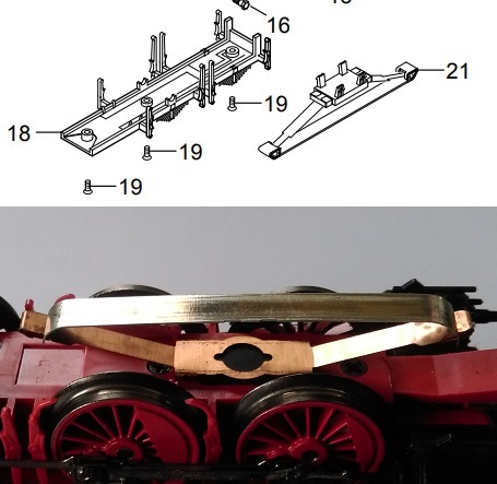

I recently posted some topics about curved points and loco running. One item that came up was the pickup shoe on a new lok that I thought was a 36740 DB 74 class 2-6-0 steamer in the 29074 starter set. Looking more closely it has a different running number it has 74854 instead of 74838 so maybe it is a dodgy budget version for starter sets?
The issue is/was that the pickup shoe on this brand new lok had a "reverse" bend in it that meant the ends could dig in to the centre studs in the track. It seems to be fixed after some careful straightening - time will tell. However, when I look at the parts diagram that came with the set's book the pickup on my loco isn't the one shown in the parts diagram.
It is clearly different and is made of thin 0.25 mm metal that is very easily bent as opposed to the 0.85 mm thick ones on my other locos. I'd be much happier if it had the thick version and better shaped ends.
Can anyone tell me if the pickup shoe from a "proper" 36740 lok (part number E144 133?) can replace the one fitted to my lok? Do they just lever out and clip back in? What is the correct Marklin part number for my lok?

What you have is the "silent" version of pickup shoes. I actually replaced the thick ones with these wherever possible, they do make a difference in the dB level. No problem running with them, when they are flattened the ends will not catch on anything. To answer your question the correspondence is:
thick | silent
E206370 | E138079 (50mm long)
E225647 | E144133 (52mm)
E306328 | ?
? | E180291 (50mm)
? | E100032 (45mm)
Here is a nice list of variants with pictures: http://www.schnug-modell...T04_Mittelschleifer.html
Careful with bending the ends, they should be straight in order to slide freely when the contact surface is moving up and down (like over turnouts). Try a bit of graphite around those tips to help the movement.

I agree with costing; I have only one loko with this type of slider (BR74); after some running in, it now runs very well. -But it did take some time. It causes no problems, and does seems slightly more silent.
I was very sceptic about it in the beginning too! ;-)

The "silent" slider on my lok came with about a 2 mm concave bend out of the box and ran well everywhere except over curved points.
As someone new to Marklin I thought, "It's brand new, it must be right". I obviously have a lot to learn ...
It's also a shame that the manual that came with the set is wrong too ...
Cheers.
