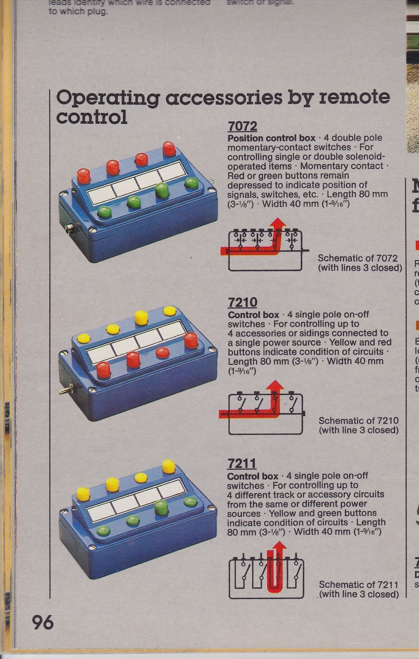

Can anyone give me instructions how to use this switch. I am hoping to use it to switch power from one track to another in the passing loop on my layout.Unsure

This section from an old catalogue may be of help:
Harold.

Thankyou Jean and Harold! Harold, your diagram helped me understand how the switches 7210 and 7211 operate, and Jean the signals manual helped me with another problem! So I am very grateful to you both!
