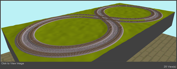

I’m planning on building two M track figure 8 layouts, one with the standard curve, the other with the smaller inner curve. Can anyone please advise what track pieces I require, especially which crossover sections (code numbers please).

Here is a M-track layout I did as per your request
Here is the track list
The layout is 80 cm by 150 cm (0.8m x 1.5 m)
Here it is in 3D
I did this with Wintrack demo version 15 (and you can do it too for free.
Here https://www.schneiderx.de/wintrack/setup15.exe
With the test version you can do all except you cannot store your work
