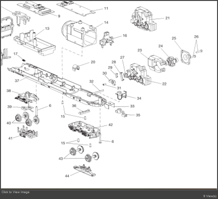

So, I got this super-nice 37605 set today!!!
In absolutely perfect condition, and I also have the 3-car extension set. A real new top highlight on my layout! Love
However, there is a problem with my feedback sections; As the loco has the slider under the motorized bogie, AND both axles has traction-tires, I can't detect it reliably when it stops at a signal. Of my more than 50 trainsets, this is the only train to have this problem! Confused
I could change the wheels, but can't find any to swap with in my collection. The wheels measures 11mm in diameter, with an axle of 2,5mm diameter. The axle has some brass bearings which must be fitted too.
Can anybody help with a source and reference number for substitute wheels WITHOUT traction-tires¿?

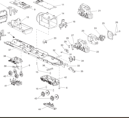

It seems like the TRIX equivalent 22100 model MIGHT have what I am looking for, but I can't see it clearly on the photos online.
Does anybody own, -or have access to- that model, and can post and/or confirm that the motorized bogies only have 2 traction tires???

Hi Henrik
I had the exact same problem with my VT11.5 37605 with the extension set. What I did is to add a pair of rail sliders (like on LGB trains but much more discrete).
I did not wanted to make any permanent changes on my collector unit so, using a thin metal bronze with a hole attached to the screw attaching the front bogie outside decoration to the bogie frame just near the slider, I managed to form a rail slider just one mm near the bogie wheel to allow a precise detection of my set.
Sorry I have no pictures (I am not near my train)
Changing the wheel set for one without rubber tires is possible but I have doubts on the result. You have to exchange wheels with the rear bogie of the motorized unit BUT you really need traction to move this very heavy train through grades.
As you may see you need to extract each wheel from its axle to do the replacing and mounting and doing so on only one axle you divide the pulling power by 2. So a slider is a better option.
You may have to try multiple times before reaching success but in the end it works and is totally invisible
#8 Posted : 24 April 2021 18:23:21(UTC)
Posts: 3,612
Don't worry about the photo; I know exactly what you mean, as I am about to do the same. -At least until I can get my hands on some replacement wheels.
I already tried that, but that is impossible, as the other wheels are of another diameter. Both flanges and axles. (They are quite a lot smaller than the motorized bogies)
You have attached the drawing of the Märklin unit (which I already have), but if you look at the same drawing from the Trix unit, you can see 2 different references for the motorized wheels. Looking at some photos online, it SEEMS that the Trix unit has only 2 traction tires; one on each axle. It's wheels are of course isolated, but the question is if the flanges can be removed, and made into one single conductive wheel-set. (It would depend on how and where the plastic bushing for isolating the flange against the axle is located)
I have no problem with the traction. Anyway it will not be divided by 2, as the trailing motor-unit will be pushing happily along with its original 4 traction tires.(**)
The photos of the Trix unit seems to confirm the viability too, although I am still not too sure because of bad quality photos online.

#10 Posted : 24 April 2021 21:23:49(UTC)
Posts: 3,612
I finally found a "nice" pic of the TRIX motor bogie.
It's not quite as I thought, as the two traction tyres are on the same axle, but does confirm the existence of a replacement wheel-set w.o. traction tyres.
I don't know if catwiki allows a direct link to a photo, but here it is;
https://assets.catawiki.nl/assets/2018/9/20/5/d/0/5d02c535-028b-400f-9f74-7a74e85ea048.jpg
[According to the TRIX specification drawing, that would be sparepart 308462.
I would need TWO of them, in order to convert them into 1 un-isolated wheel-set... *IF* only one side of the flanges are isolated!
¿How are Trix DC wheels normally isolated?
PS: I made a slider as mentioned by Johnjean, and it works. But it is quite flimsy and I am not too happy with it. But at least I can let the train run on my automated layout, and ENJOY the spectacle! ThumpUp
